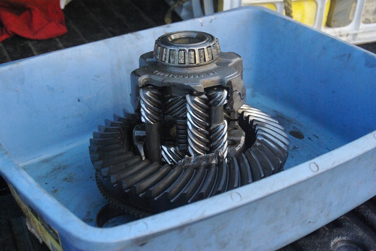

The kicker was the pinion. At first I was going to just leave the pinion and swap the differential. After much debate I decided it would be best to pull the pinion to make sure the bearings were ok and make sure there wasn't metal bits in there. The bearings looked beautiful, I was happy, until I notice the chunks out of the pinion gear itself. So, since I didn't feel confident doing the pinion setup I decided to take it to someone who knew what they were doing.
I pulled the differential out saturday, here's a pic for anyone interested.
