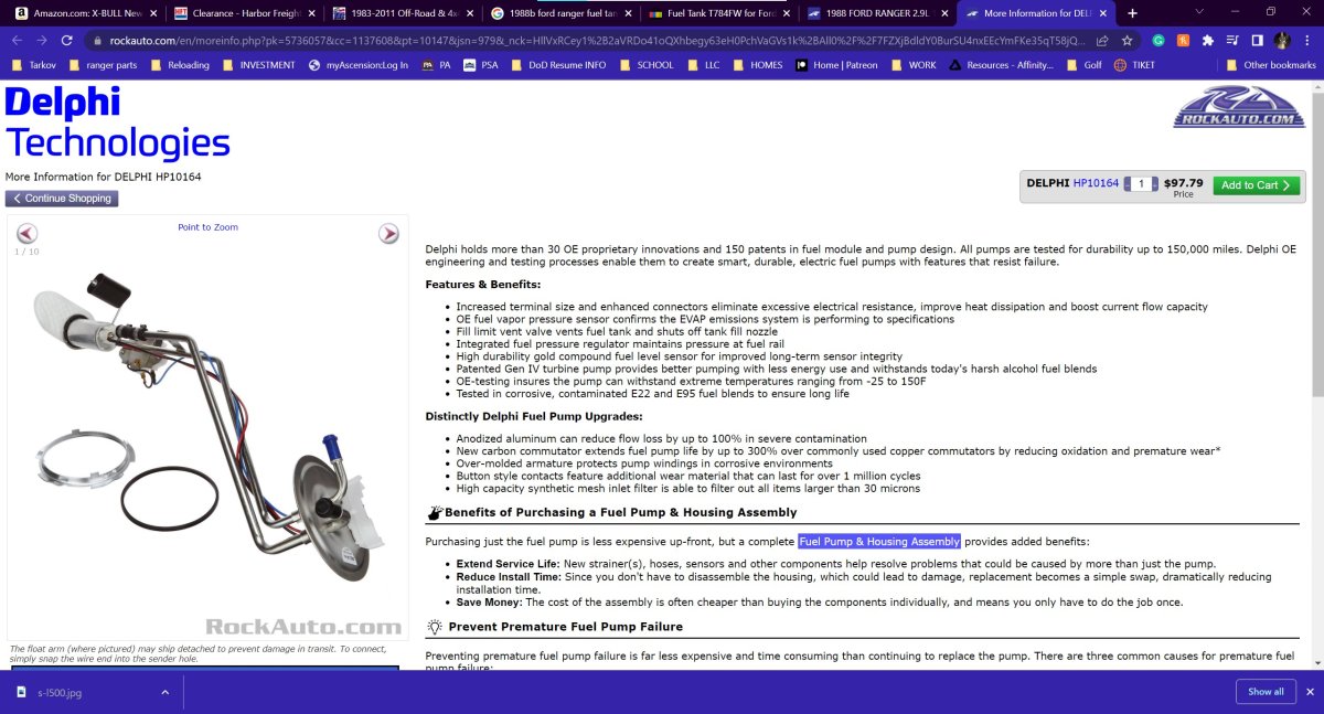

The second pump I tried was the one that makes two bends (45 and 45) and still can only use about 10 gallons before the gauge reads empty and starves of fuel.

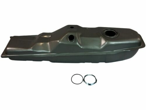

I currently have the one that makes two bends (45 and 45), do I just have it rotated the wrong way? Does it matter which way this pump sits in the tank (facing rear vs facing front)? I am tempted to pull the sending unit that's in there now and bend it down to reach the bottom of the tank... Have yall every heard of anyone doing this?
The attached picture of the tank is model I have.

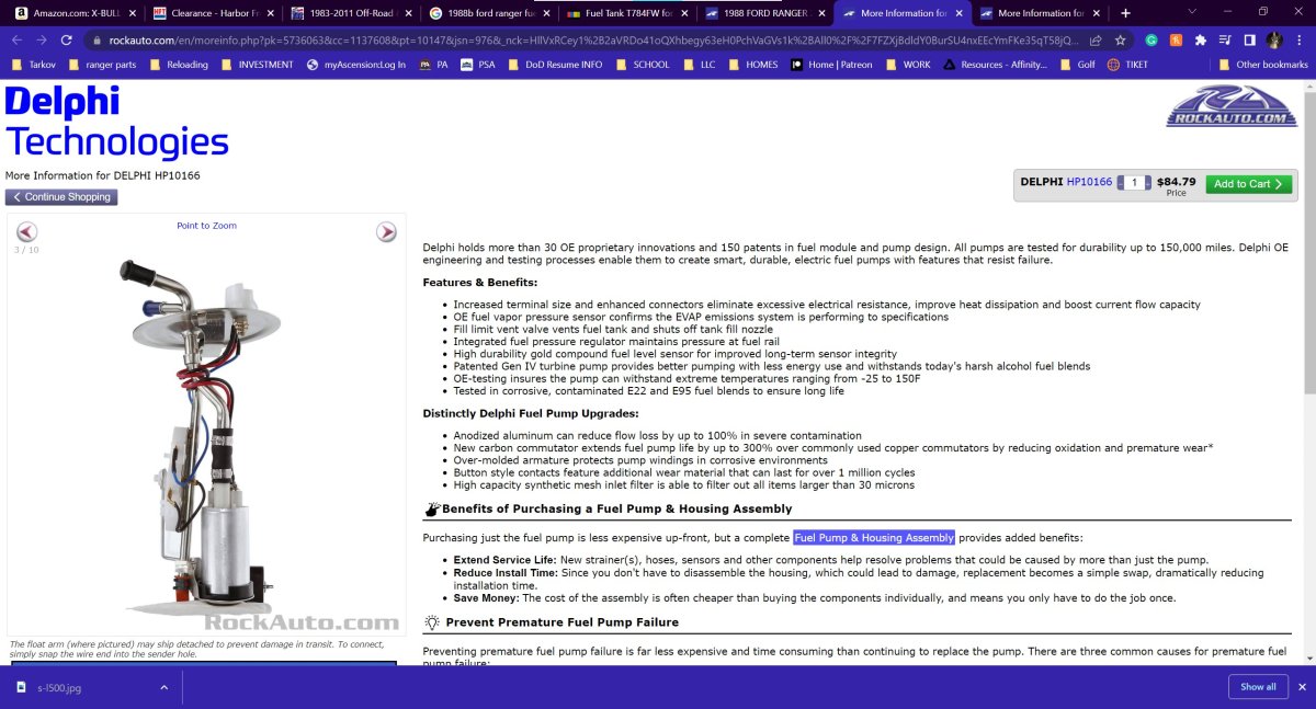

The Fuel pumps I have tried are below with Part Numbers attached pictures:
DELPHI HP10164 (45 and 45) Currently in the tank
DELPHI HP10166 (straight)

HP 10164 is what rockauto calls for the extended cab pickup midship or front tank.
HP 10166 is for a ranger rear tank.

Does it look like a Ranger stock metal fuel tank?
There are 2 baffles inside, but they have passages that let fuel flow into fuel pump/float area at the bottom and are open at the top
Maybe baffles are plugged up at the bottom, so when you fill it up gas fills up the whole tank
But fuel pump and float only get, have use of, the gas and level in the center area, or one area, because clogged baffle prevents gas from coming in from other area behind baffle
So gauge is right for that area of the tank
I would run it down to 7-9gal left then siphon the rest out and look in the tank for old sock filters or ?? clogging baffle passages
1988 Ranger gas tank picture: https://i.ebayimg.com/images/g/KnMAAOSwPexfGbZN/s-l500.jpg
Assembly hole is at an angle which is why the pump is at an angle

I attached a picture in the original post with the fuel tank I have (assembly hole in the back flush) and the fuel pump that I currently have in it is the one that makes two slight bends which puts the end of the pump in the center of the tank. If i use the straight down pump (vertical) the pump would be at the very back of the tank. Which pump am i supposed to have if I have the tank i posted in the original post instead of the one that you showed?

Doyou have a reference picture or schematic of what the inside of the tank looks like? Like a cut-away model of the inside design so that I can easily identify where the baffles are and where they could be clogged? I have not been able to find any pictures of teh inside of atnk and do nothave an extra to cut open. Tough to see through that little opening.
