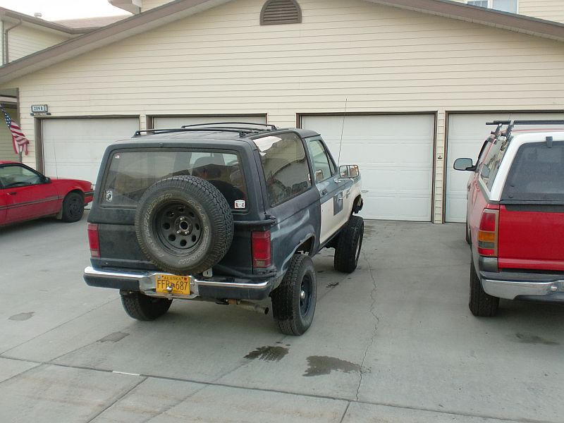

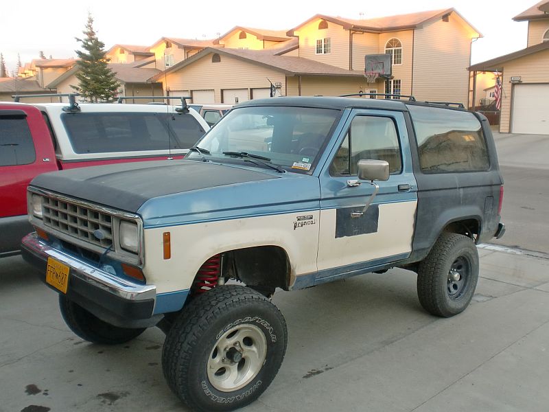

I pulled it all back out and reinstalled the swing arms from the upper holes. I noticed they were spaced out a bit further than the bottom holes. Everything went together much faster this time at least. Now everything fits. Didn't take any pics of the axle issue but that is resolved now. Here are some pics of the lift installed. Did a quick mark 1 eyeball toe in adjustement and took it for a spin around the block. Noticed right away the steering was wonky. After getting back and seeing the way the camber is sitting now explains the steering! Good thing I earler today ordered a drop pitman arm and Ingall adjustable camber bushings. I was hoping it would be close so I could drive it to work but I'll be bumming a ride to work again it seems. Thanks for the suggestions. Should I ever lift another one I at least will know what it takes and what to look out for. And yep I know I'll need some blocks in the rear. I was hoping the belltech shackles and expo leafs would work together for enought lift, guess not. Even like it is I can already tell the ride quality is light years better than it was on the stock suspension.
