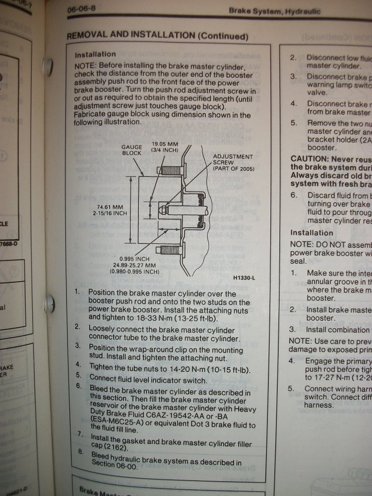

Just went through this replacing the master cylinder on my '94 Explorer. I measured my push rod, and it did not need adjusting. Here is the factory shop manual brake master cylinder installation instructions for the '94 Ranger and Explorer:
63122
You're likely fine just bolting the new one on, but this would the right procedure to check yours, if you'd like to be sure.
