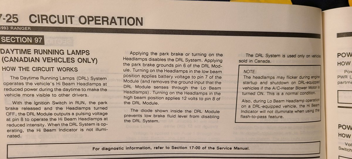

ok thanks! I appreciate the photo, i'll go check.

I just learned that the DRL module is also disabled by turning on the headlights with the switch.
It sounds like the DRL module is stuck on. The DRL pulses power to the hi beams, so they won't look fully bright. It looks like pulling fuse 21 will kill the power to the DRL, and still let the headlights operate manually.

It seems to be the lowbeams that are always on. Which is even more strange, if what youre saying is true about the DRL energizing the high beams.

Are you SURE it's the low beams that are on? Or does it just seem that way because they seem more dim than normal high beams? See the explanation I just posted.
That fuse also controls the light under the hood. Not a big deal.
I was under the impression that they the same bulb? How would I tell the difference? All I can see is the lights that are always one seem less bright than the lowbeams that I switch on manually.
You are correct, when I remove the 15 amp fuse 21 in the engine box the lights still operate manually. I'm leaning towards the DRL module acting up. I was totally unaware of the DRL until the replies on this forum, which now is a relief. I was so confused as to why the headlights seemed to be on two different circuits!

There are 2 different filaments in a headlight bulb. Think of it as 2 bulbs built into one. The DRL module uses electronic magic to send less energy (still 12 volts) to the high beam filament. So it's in but dimmer than normal.

No, it's not "gaining power through a short"; and yes, it shutting off by your pulling the fuse proves that.
The DRL module takes power from the battery (through the fuse that you pulled) and it pulses that power very rapidly (I suspect it's just a control circuit and a big power transistor) and sends that pulsed power to the headlight hi beam filaments. This causes the headlights to light, but at a reduced level whenever the ignition switch is on. Turn the ignition off, or turn the headlights on manually, the DRL turns off.
Your DRL module has failed, because the transistor is stuck "on" all of the time. Pull the fuse, you're removing the power to it.
I think that somebody posted the schematic for the headlights; look it over, follow the circuit paths, and hopefully things will make better sense.
