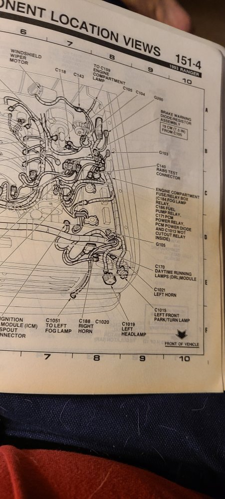

yes just the headlights. also, do you know where the DRL module is located on a 93 ranger 4.0? can't seem to locate it.

The DRL module, if you have it, is located behind the driver side headlight.
