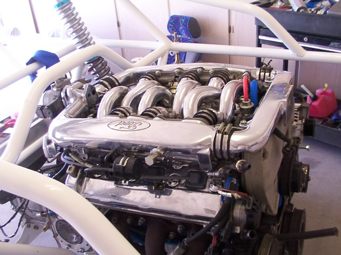

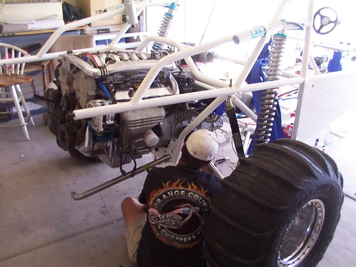

The SHO engine would be a great swap for a ranger.The Taurus that it comes in is about the same weight as a ranger and as a previous owner of a couple Taurus SHO's and after installing one in a 5 seater sandrail I can tell you first hand that if you think that the ranger would be slow you better think again. I have put my 90 SHO up against many of mustangs and they do get the jump on me and then after that watch out becuse that little SHO engine winds fast and I will be pulling on you by mid second gear. Stock for stock the SHO will beat a 85-95 mustang 5.0. I am not dogging any one here just stating my dealings with these engines.If you have a 3.0 or 3.2 SHO engine I say do it and SHO every doubter out there whats its all about.:icon_thumby:

Well after doing a 3.0 SHO in a sandrail and personally driving it I would say that it has quite a bit down low to. It would be a way better swap then doing any 2.3 turbo or not. The sand rail I did was built to run at the dunes and it would pull the front tires and ride wheelies and yes I know its a rail but it was a 5 seater and the rail weighed alot. (I would agree that it might not be the best bet for a 4x4 but dont rule it out for anything else). We turboed it later on and that thing was a FN monster. Here is a couple of pics of the rail so you can see I am not just blowing smoke.

Comparing your sandrail to ANYTHING is a waste of bandwidth.
That thing probably weighs less than HALF what a base ranger does.
a Lightweight vehicle makes torque less important.
