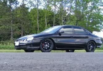

my truck will be at carlise im there every year with my SHO and i build cars that are award worthy i got 2nd place with my sho
i may be new the the ranger crowd but im a big player in the SHO world
