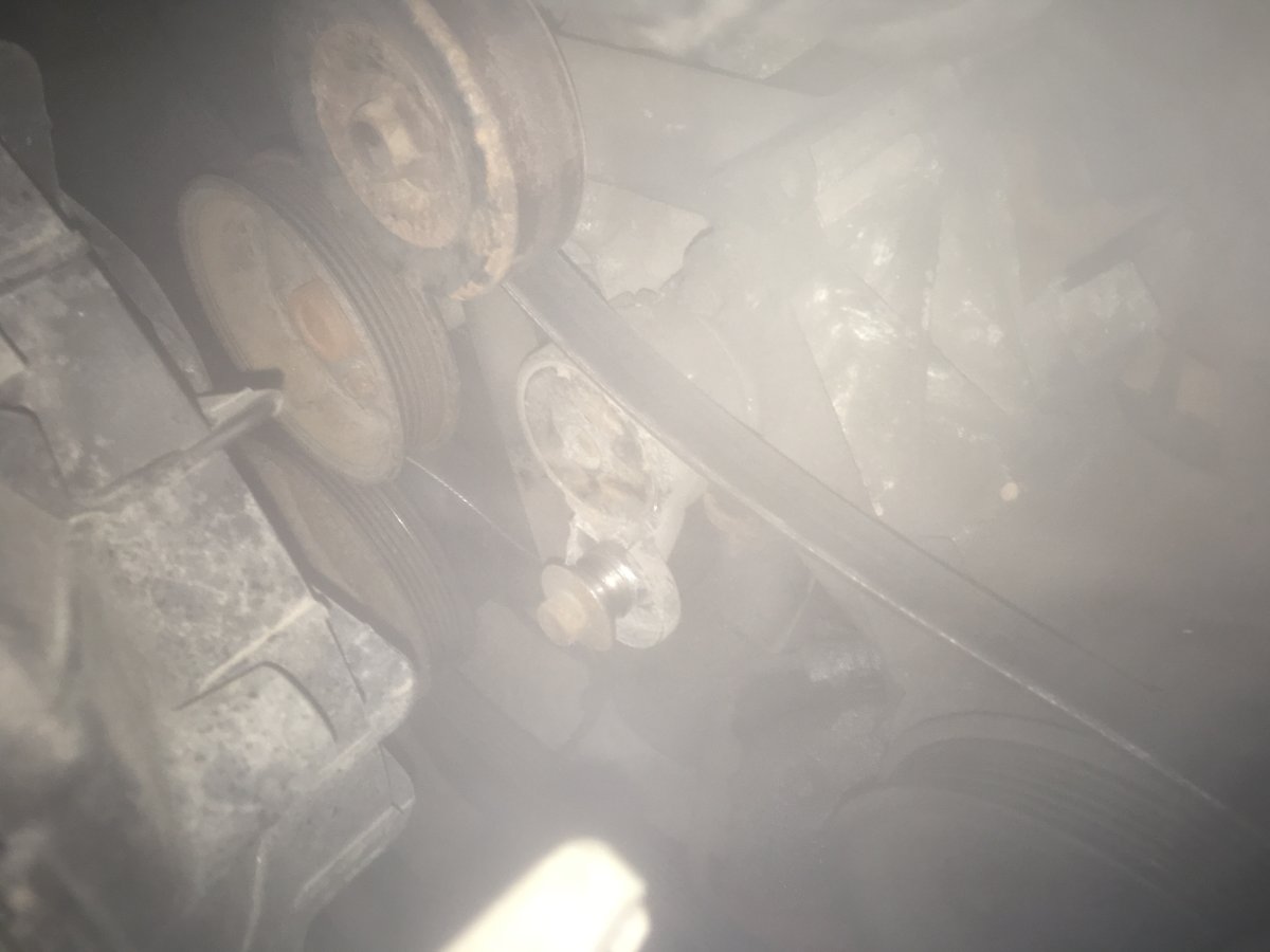

While I was driving today the headlights suddenly got dim, the battery light came on, and I lost power steering. I pulled over thinking the serp belt broke and I already had a spare with me. Instead I found a splattering of what looked like some sort of oil (from the idler pulley?) spattered around the fender liner which smelled burnt and the tensioner minus the pulley. By the looks of it it seized up the bearings. I never heard anything. I don't think it damaged anything else luckily. No obvious damage to other components when it happened and I'm not leaking anything so that's a plus. I'll call around in the morning to see if anyone has a new one nearby. I'm in the middle of rural quebec so that will be fun. I just figured I'd share what happened since it seems so weird to me to have a pulley explode without warning and not even take the belt out with it.

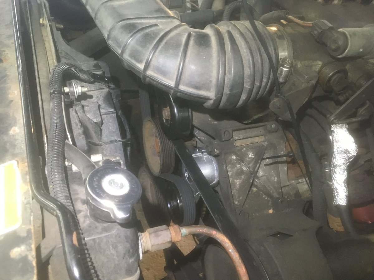

Nice to hear all your experiences with the same thing. It worked out pretty well for me in the end. I used CAA (canadian AAA) in the morning to get a free tow to the nearest NAPA which had the tensioner in stock. They had another engine rebuilding business on the lower floor and they let me use their tools. I had a socket set on me at the time but a previous owner replaced the tensioner bolt with an 8mm one and rounded it completely so I needed an extractor set. I also replaced the other idler pulley since when spinning it by hand it sounded like its bearing was shot as well and I didn't want to get stranded again. The replacement idler doesn't seem as good quality as the original though. Completely plastic instead of metal where the belt rides. We'll see how it lasts.

I think they might be designed to fail without damaging other stuff. Mine did not cause any damage other than the belt, which probably could have gotten me home, but I always keep a spare serpentine belt in my vehicles. Its crucial, easy to change and takes no space.
Anyways I unbolted what was left of the idler, bolted on the new one and set in the new belt. one 3/8" drive metric socket ( I think its was a 14mm) and a breaker bar for the tensioner was the only tools needed.
