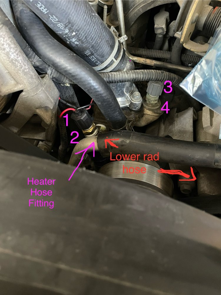

Hey y’all. I have a 2002 3.0 V6 Ranger XLT. I can’t find the exact numbers for these parts, does anyone know which is which?
Parts #s would be great but any info is appreciated. The #1 sensor is what I really can’t find anywhere…it is supposed to be a ONE WIRE pigtail but I can’t find it anywhere. I had to ground the black wire but I really do need the 1 wire connector. Thanks

Here's some info. Are they both ECT(engine coolant temperature) sensors? There are two in the list in this attachment. The 12A648 searches as a legit number. That's the one to the right in the attachment. The other one is called a "sender"
If you look your truck up on www.rockauto.com, look under "cooling system" and then under "temperature sensor/sender". They have a bunch in there, don't know if you can make heads or tails out of them from the pictures.
Hey Franklin! Thanks for replying. It would be B227 and B10. B227 is an ECT Sender, and B10 is an ECT Sensor. I need the Connector for B227, otherwise I'll have to find a better spot to ground the negative pigtail; it's not a great spot for finding a ground in terms of distance to the engine block. It only has the one wire since the sender is self grounding. So I need the one wired connector for the B227 Sender. I may have to go to a junkyard. Apparently from what I've found these were not in a lot of post-2000 models. It would be this (https://www.rockauto.com/en/moreinfo.php?pk=15245197&cc=1438306&pt=4748&jsn=558) with a one-wire pigtail. Thanks again!
