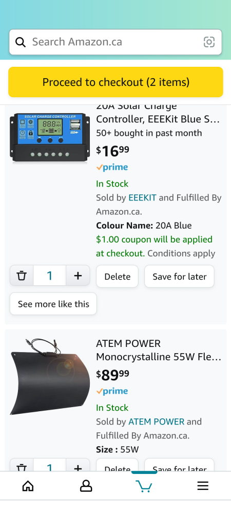

Currently I'm searching for some solar panels. I've thought of flexible ones, rigid ones. Still undecided. If I could find 2 30 watt panels that were the size of racing stripes, I might put them on my hood and just glue them down with silicone.
So I ultimately went with a panel that will glue to my roof just in front of a basket, where a sunroof would usually go. 55 watts, and a 20 amp charge controller with dual USB plugs. I have used 2 of these controllers before and they do just fine.

I like these charge controllers. I mounted my last one to my dash among the guages and I watched my solar uptake a lot. Definitely did affect where I'd park if it was low, but for the most part, it was just so much power I could never use it all. And in the Jeep it was just on an AGM deep cycle that also started it up.

Northern BC here. Definitely not as good in cloudy conditions, but with the isolator kit, there's always the engine/alternator. I like the charge controller for the digital readout. Easy to see where I'm at. I had the Jeep dialed in pretty good. Never once ran out of power. I don't run a fridge or anything. Just charging cellphone, tablet, laptop and 18650 batteries for my vape and flashlights
