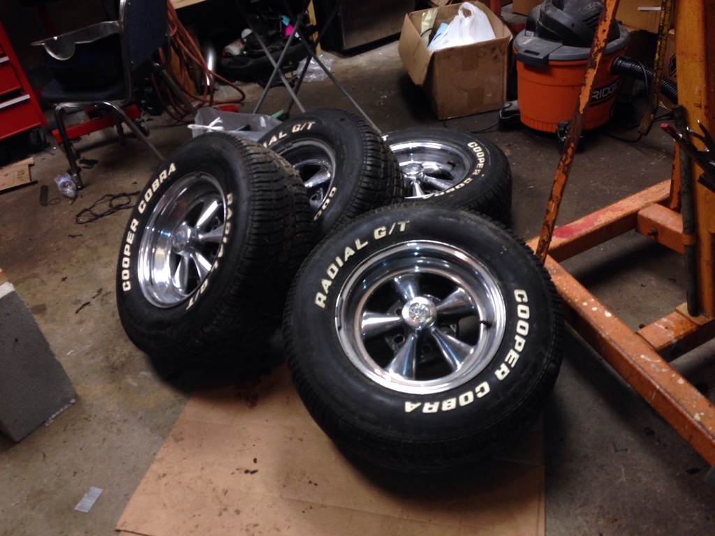

so far ive got 80 percent of the parts i need to do the swap. only thing im slightly uncertain about is the gauges i ordered. not sure if im cool with them or not
