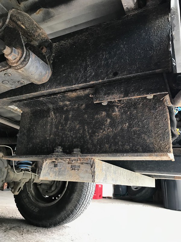

well my rear frame from the spring hangers back was in real bad shape, I took some heavy channel iron and put over the ends. Ive heard of those repair kits and its about the same as what I did, just not as heavy of metal. I’ll go look for pics
well here it is, I also used a product called POR-15 to coat everything with.
IMG_20170716_111258 by anon omus, on Flickr
IMG_20170718_174930 by anon omus, on Flickr

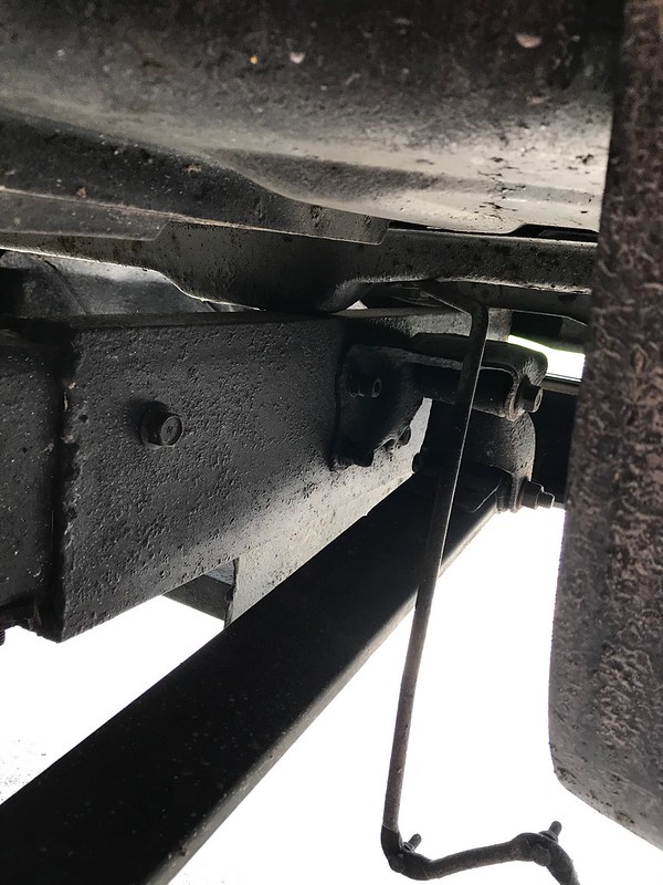

also be aware shock mounts can rust/break off. I had it happen when I went to go get my 4.10 rear axle, so I made this:
IMG_20170726_064202 by anon omus, on Flickr
Untitled by anon omus, on Flickr
added another peice to drop down so I could have a crossmember and add a 2x2 receiver square:

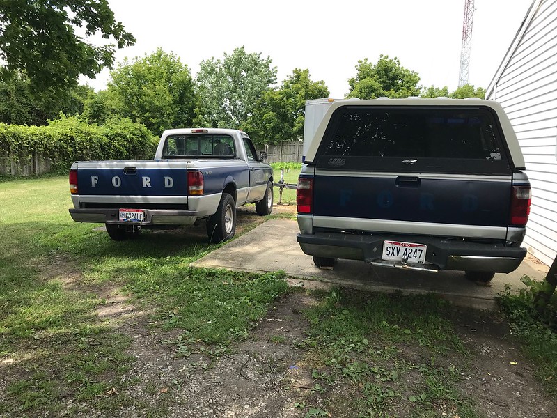

it did work for me, I do think the bed is structural now. plus bed is 1/4 higher and rear bumper is 1/2 lower. so gap between tailgate and bumper is bigger, not much but noticeable. added a "gap filler" (plastic political sign remains) and painted it black to clean things up.
you can kind of see the diffrence here, the ranger with the cap is my ranger trailer, doesnt have quite the gap that the truck does. a better picture would of been with truck and trailer right beside each other.

Thanks for the reply RACSAN and pics Mine is most likely just as bad I just haven't messed with it yet I was going to buy new leaf spring mounts and shackles to raise it some when I was inspecting the area I noticed the mess. and most likely when you start disassemble the parts it will become much worse When I put new rear shock mounts on, passenger side was fine when I got to the drivers side and started drilling out the old bolts a piece of the frame crumbled had no problem with the other 2 bolts a few days later heard noise coming from the rear on driver side when I checked it out the area where I bolted the new shock mount just crumbled I removed the shock and had someone weld a piece of steel to the area and now its fine. This is no surprise to me at all My buddy owned a 2001 and the frame cracked 3x it looked like someone submerged it in salt water in the rear it just was covered up with undercoating I can do most of the work myself except for the welding It wil prob cost me around 600.00 parts and labor if I do it I am replacing both leaf spring brackets and shackles and hope for the best. again thanks for the response
