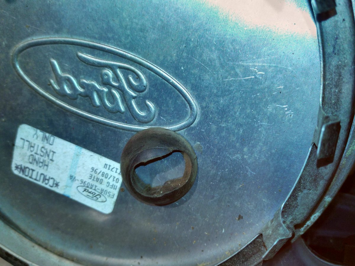

It is probably the piece of plastic in the pictures below, that I took of an used one I have. If you shift your transmission to neutral and take everything off, you should get to this plastic bushing. If I would hazard a guess, I would guess it is hogged out on the underside where it sits on a cross pin. But, it probably has been ten years since I took one of these transmissions apart for an engine swap, so, take it with $0.02 worth of advice that the wear is on the side you can not see unless you remove the bushing.

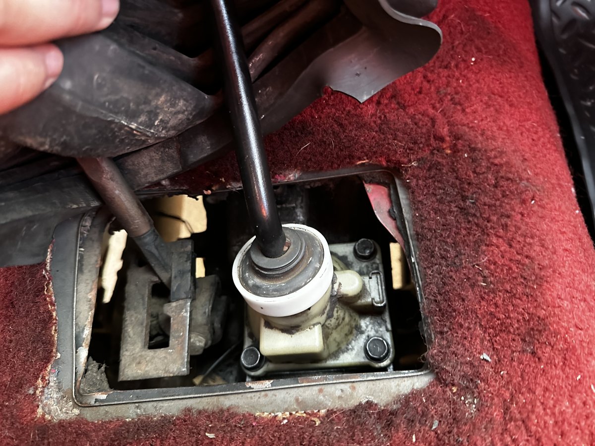

Mechanic said this might be it, but he thought they were usually white. Any idea what its called?
No idea since I do not have an exploded diagram for the transmission, but, I did check my build sheet for the vehicle and it had a 2x4 TK5 transmission.
May I suggest putting the transmission in Neutral and removing the 4 bolts and looking yourself? Do be warned, the stuff might fall out. It would not hurt to stick cardboard or your fingers under the shifter while lifting it.

I showed your picture to my mechanic, he said that’s what I’m looking for. Can’t find the damn thing anywhere!
