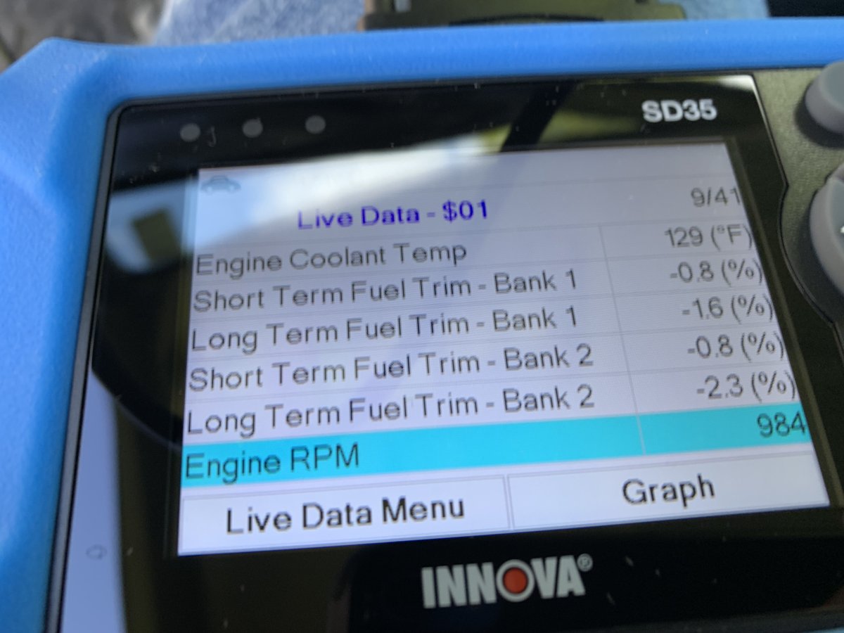

I guess there is no vacuum leak looking at short and long term fuel trims. Fuel % drops a couple when revving the engine to 2500rpm and it would be over 10% if there was a leak right?

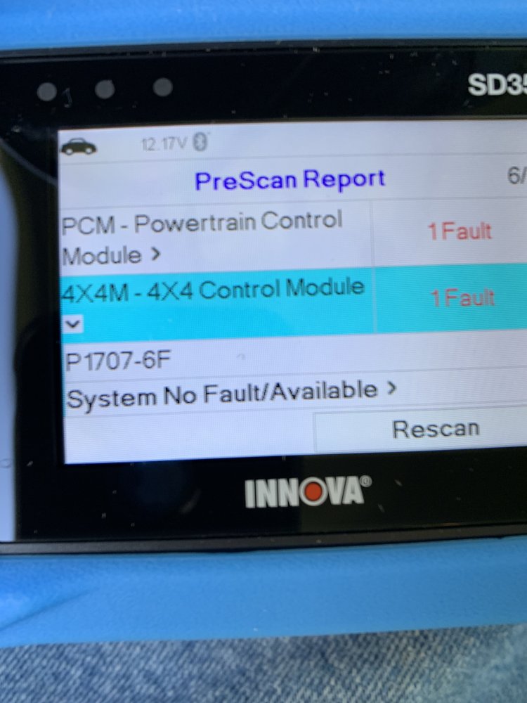

I did find a transmission fault 1707-6f? I’ll have to start a new thread to ask what this is about. Plenty of internet posts on a p1707 code but none I can find on p1707-6f
