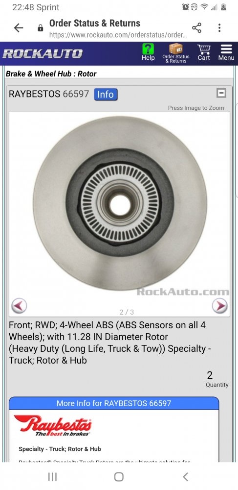

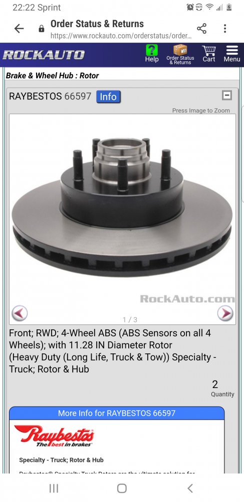

Hi all, I have a 2000 4x4 XLT with vacuum pulse hubs, 4 wheel ABS and 140,000. I'm trying to keep the vacuum hubs, they work fine for me. I'm looking to replace brakes, cv axle and hubs. I just bought Raybestos 66597 rotors on Rockauto. I just realized they are rotor and hub assemblies (I think thats what they are called or maybe captive rotors? See pictures)....I was trying to buy just the rotors but I'm planning to replace my hubs too because bearing need replacing. I saw the hat on the rotor and started questioning if these were the right rotors but now I'm wondering if I can install these at all if I return the vacuum pulse hubs. Should I buy new rotors or can these be a substitute for my hub replacement as well? Is there bearings I can replace instead of replacing the hub?

Those look like 2wd rotors... You can see the outer race for the spindle bearings already pressed in.
it says Rwd on the description.
