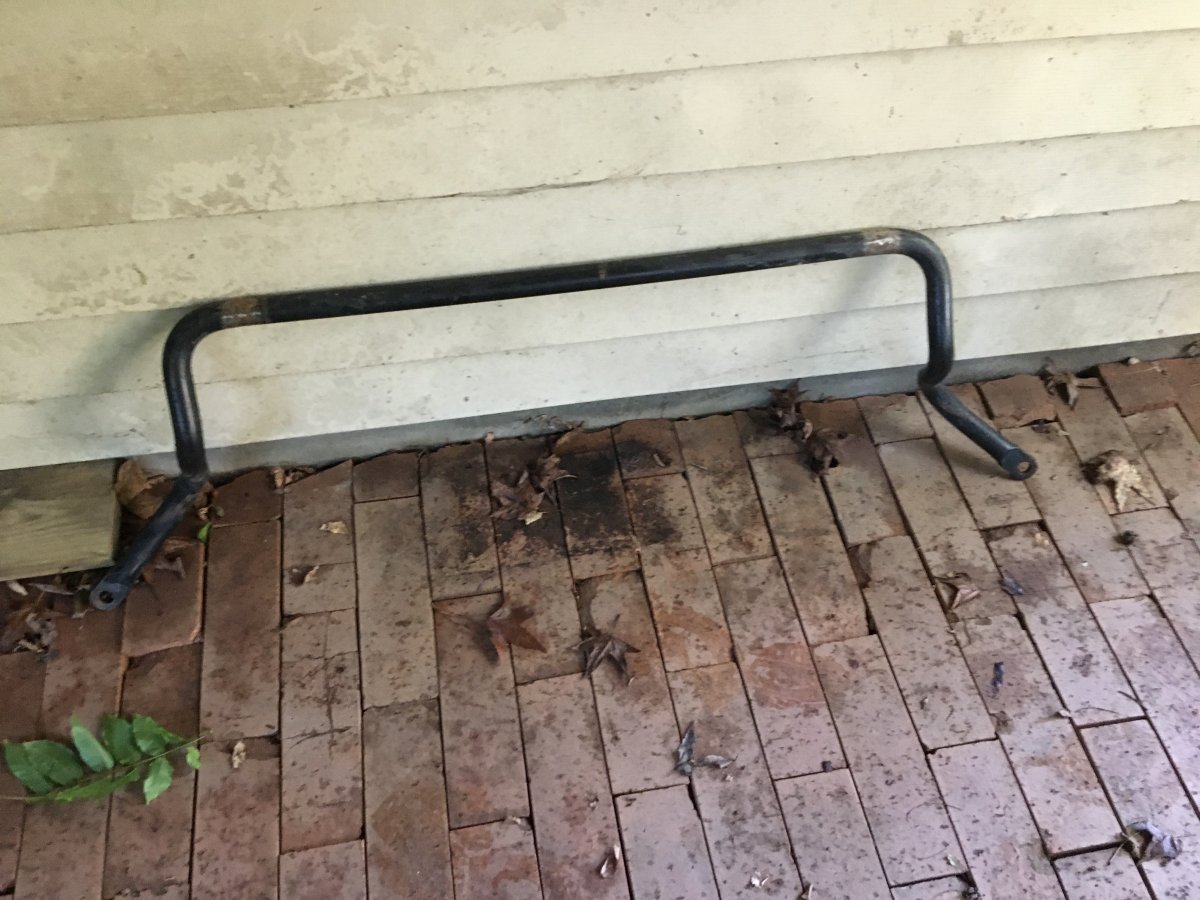

The other surprise there is I was thinking of like a five-eights or three-quarter inch steel rod from Home Depot inside a sleeve like a pipe nipple, but of course thicker than a pipe nipple. In hindsight what they came up with makes sense, The shaft has to be like the neck of a trailer ball. I have to use at least a three-quarter inch, preferably 1 inch high carbon/hard steel rod due to the sheer value. I got the shaft cheap by picking up a sway bar out of the scrap pile at the pull a part. I think it’s 1 1/8 inches and I’ll chop out the middle. See pic.

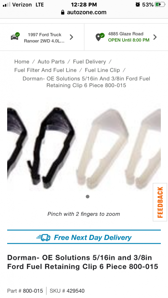

This is the clip on my sending units. The plastic clip pjtoledo shared is for something else, but still many thanks, it got me on track.
These black and white clips are on the other end of the lines at the tank selector valve. & again, this is on my 1996 4WD F250 7.3 Diesel, but the reference materials say it’s the same thing on this 97 ranger.

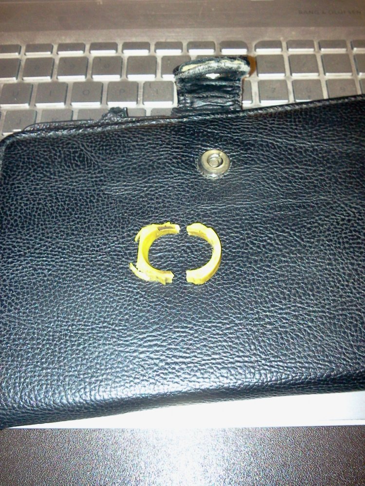

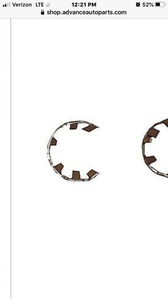

It was sprinkling rain on and off today so I never went back under the F250, but I think I figured this thing out. The clips on this F250 seem to be high carbon steel, hard and springy, but they can still deform. This is what I’m thinking: when you drop the tank, it ends up hanging down on those fuel lines, which may bend the fingers on the clips further inward. Then, when you’re struggling to pull the lines loose, you keep putting pressure on those little clips, bending them inward even more. Once you do this, the little shim tool won’t push the clips fingers out far enough to get them to clear the sending unit line collar. I think the clips deform as you pull on them, and they bend further in against the stop on the sending unit, and that makes them even harder to release.
So here’s my question: is there a way to just force the line off even if you damage these clips? The clips are available at the auto parts stores for about five dollars. So there must be some way to get them off, even if you break them, without damaging the lines or the sending unit. Yes/no? How?
If you can't get them off any other way, you can cut the line close to the fitting then cut the fitting off. You can buy replacements on a short piece of line. Just need a double barb to put them together.
Thanks. That’s actually my last choice if I can’t get anything else to work. I joke on my “Rick-storation” and on Rick’s Ranger Rig” that I’m going to do it as cheap as possible, and I will, so I don’t mind modifying things as long as it’s safe. But on something as nice as this F250 I like to keep it all original. I bought it new and it’s still almost looks new.
An update. I had soaked both fuel connections with PBBlaster penetrating oil a couple days ago. And I bought some new clips so I could see what they look like and how they would catch. As I mentioned, the harder you pull on the connection, the more you deformed the fingers of the clip, and the harder it holds it in place.
And I bought some new clips so I could see what they look like and how they would catch. As I mentioned, the harder you pull on the connection, the more you deformed the fingers of the clip, and the harder it holds in place.
Today, I got under the truck, where I could actually sit up straight with the connections in front of me. I had pulled the tank by taking out the sending unit. On that F250, it’s a cavern under there. Are used a tiny screwdriver just a little bit bigger than the big one you would use on eyeglasses, and I worked it in there and wiggled the clip around (or at least I thought I wiggled it). I took a pair of long nose vise grips and gently grabbed the whole side of the connection where the retaining clip usually sits. I used another pair of vise grips on the line I was working on, grabbing it at the first elbow so I could pull those vice grips straight out while the needle nose held the line back. I put the shimmer release in place. When you slide it in you can feel where it pops into place just before the seats all the way down. I started by working the connection together to try and free the clip, and then I pulled it back, both times twisting it back-and-forth. I had to use a lot of force with my arms, and wiggle it back-and-forth, but the connection did come loose. Again, I was doing this right in front of me, comfortability, I wasn’t trying to do it in an awkward position on top of the gas tank. I think if I had done that I would’ve never gotten it loose. Even with the penetrating oil, it was fighting me every inch. The good news is I got the lines loose, I took the sending unit apart, I polished the steel face where the two little fingers from the connection ride, and put it back together and it’s checking out perfectly with the meter.
