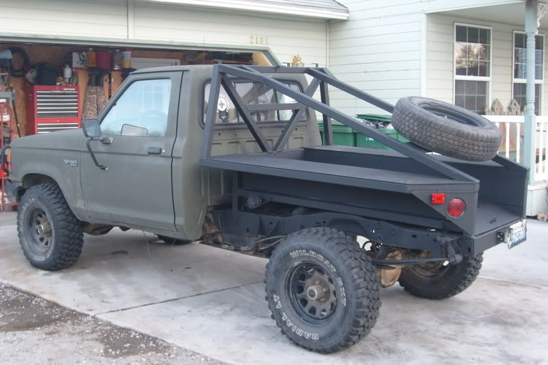

So far I have a 12 gallon summit poly fuel cell, it is foam packed and built for drag racing, I am going to mount that in the bed and ditch the stock setup that looks like it might get hung up on something. I am also going to build a bed that looks like this one.
It will make a lot of tire clearance room, lighten up the truck a little, and be less metal to get hung up on wheeling.
