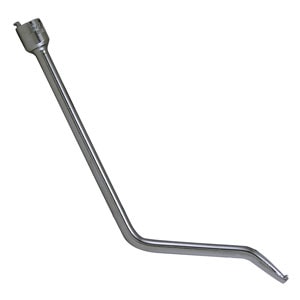

Also, make sure you have a good brake spring tool and that you know how to use it before starting. Don't get one of those stupid scissor ones with the spring hook on it, they are dumb. Get a solid one, and a separate T-handled hook.
lol stop looking in my Amazon cart! I was super tempted to get one of those all-in-ones to save a little cash. But thank you!
Most people go for that one thinking it will be more convenient to have the tool all in one. Unless I am working on 3/4 ton brakes where you have to have that spring hook on the scissor they just piss me off by flopping all over and getting in my way. I find a straight one like this and a pirate hook much more manageable and convenient to use.
3
^^^^^ That tool was the best thing I ever bought for working on brakes until I bought a good vacuum bleeder setup. Both are life-savers if you do brakes by yourself very often.
