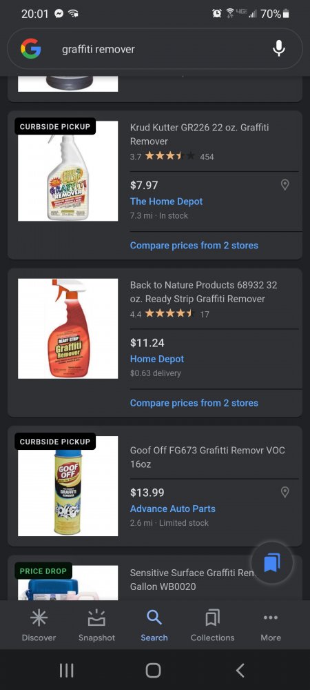

They make cleaners for removing graffiti that would work. But they might cost as much as buying new domes, or maybe not.
Hell... never thought of goof off.
In the bag...
