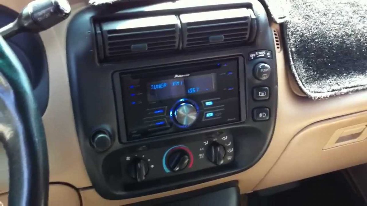

The last time I did an aftermarket swap the entire bezel had to come out. I also discovered that most aftermarket head units will require a custom trim bezel (Scoche for example) that the head unit slips into. Usually the very bottom of the OEM bezel will need some trimming to get the aftermarket trim bezel to fasten into the OEM opening. Photo shown is not my truck...
