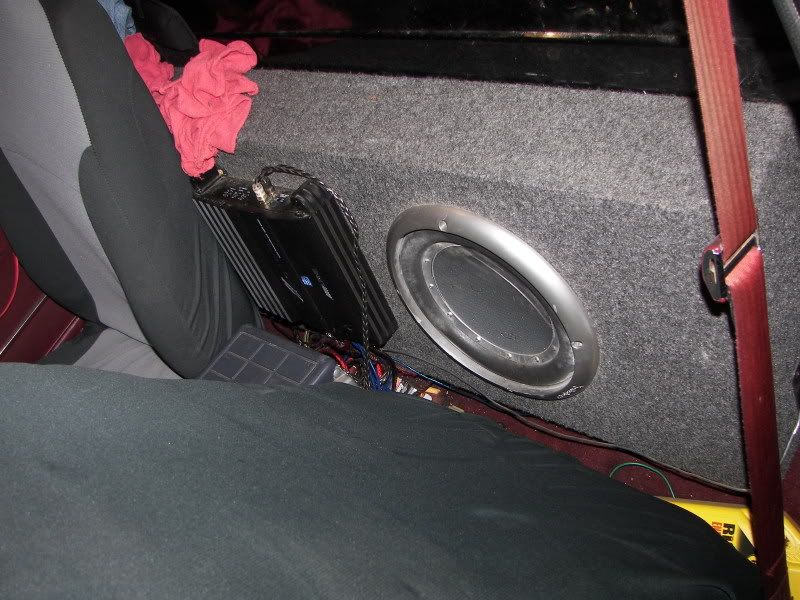

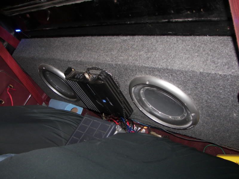

I am in your same situation. I got a single kicker cvt shallow sub and i made a custom box for it. The mounting depth is like 5 inches i belive.
there is pleny of room just go wide and thin i dont think you are going to need a shallow there just extra $ you can spend on sound deading
those look nice.. do you have a 12 or a 10?
the 12" mounting depth is 4 5/16", plus your mdf thickness doubled up(front and back of box)
the 10" mounting depth is 4 3/16", plus your mdf thickness doubled up(front and back of box)
it's practically mocking me, telling me i should get the 12 instead of the 10, if you have the money.
it's 2/16 of an inch deeper, and the box only needs to be .2 cubic feet bigger for the min rec volume. (so if i did my calculations correctly, just increase the length width and height by all .6 inches, and you have your .2 cubic feet right there, slightly over .2 cubic feet anyway)
those look really nice, how is the performance? and what amp do you have driving them? i'm interested in those.

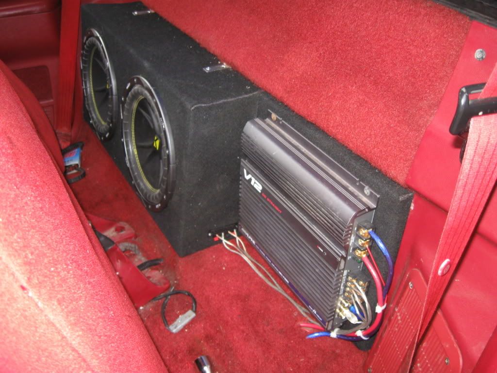

Heres mine.
Two Kicker 10's...
Drivers seat doesn't move forward at all!
http://www.youtube.com/watch?v=JVJ63Y3TfBc
Heres mine.
Two Kicker 10's...
