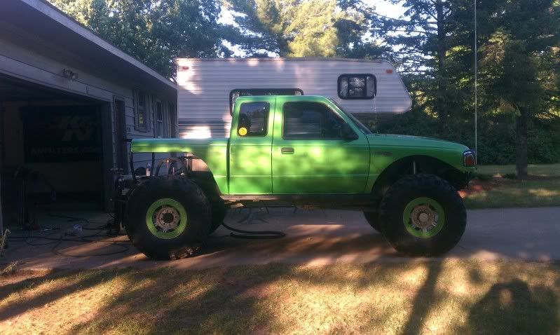

this has been done. Look up Kyle M.'s build. He put an ex cab on a regular frame.
Yes, but Kyle is also running without a bed on his current truck. He has fabbed up bed sides that he can put on to look legal.
Which still begs my original question to the OP, whatcha gonna do about the bed?

that thing is nasty lookin.
