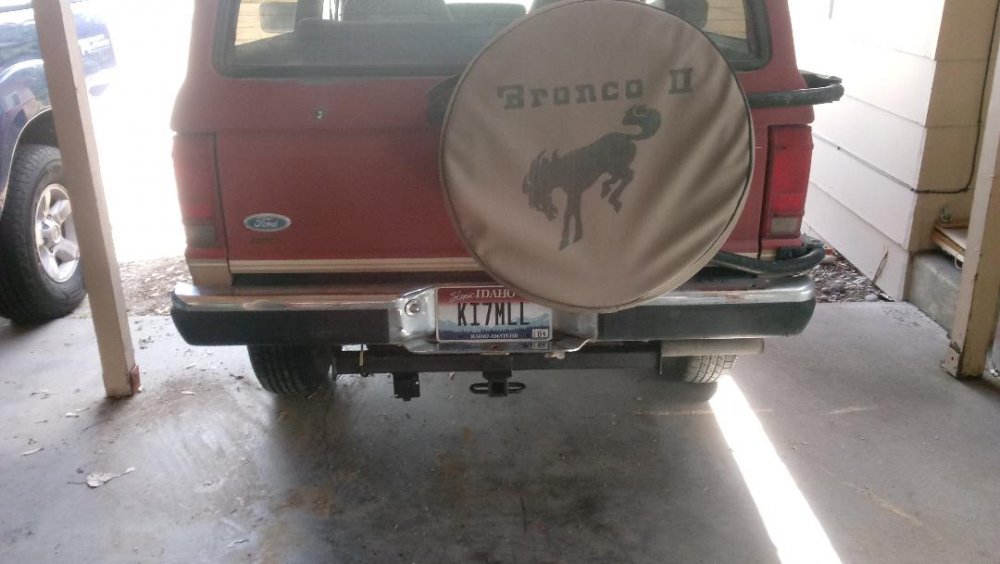

I did finally get the receiver hitch installed, used 4 1/2" grade 8 bolts, washers, lock washers, lock nuts. Receiver hitch isn't going anywhere....the thing will probably never pull a trailer anyhow, but figured it would be good for one of those cargo carriers if I need one at some point, but for the $20 I paid for the receiver hitch I figured it may as well get installed LOL.
