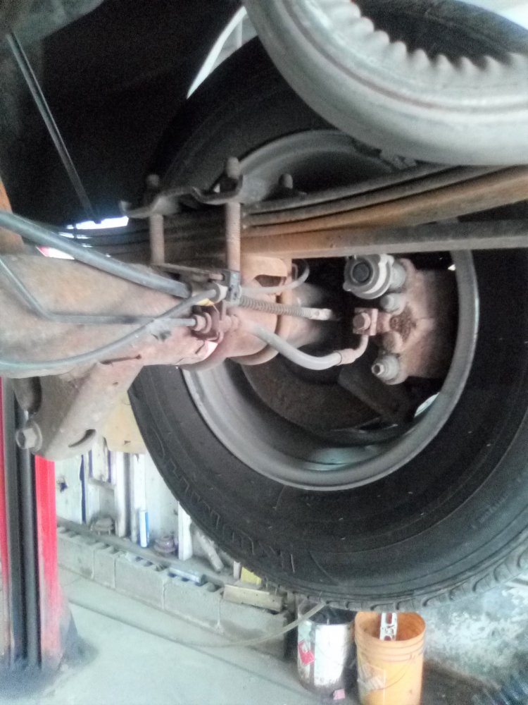

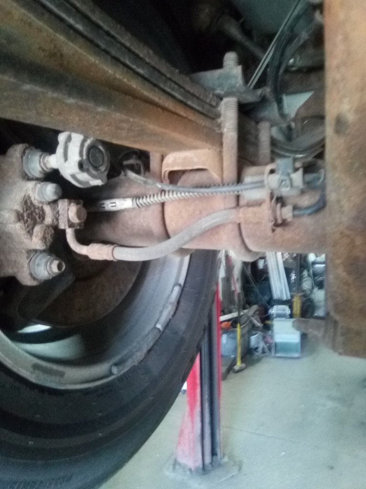

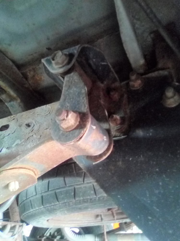

Got it on a hoist today. Looking good. Just leaf springs flattening over time.

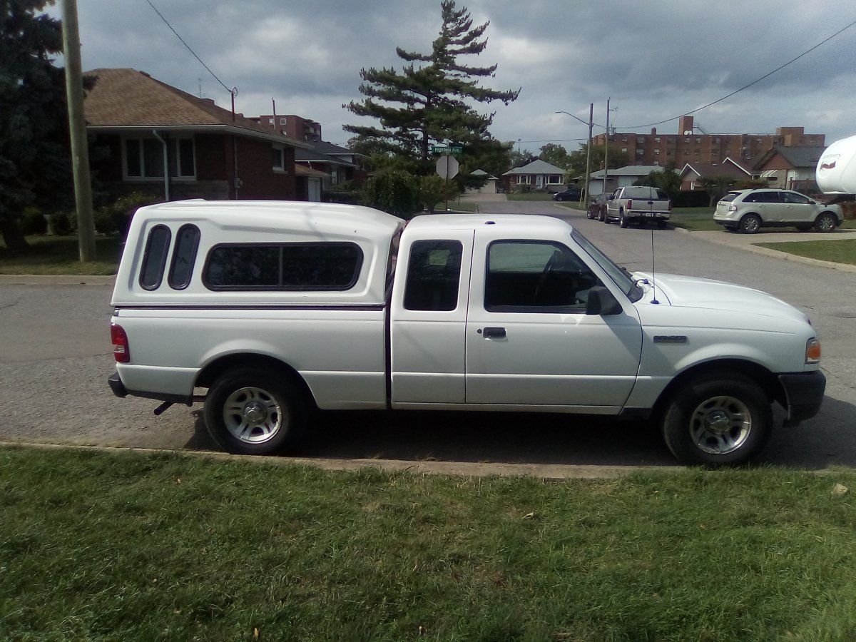

Here is a pic with a load of dirt in it. Much more noticeable with the extra weight (probably close to 800 lbs).
That''s not too bad. When you have the rear tires stuffed into the wheelwells.... that's when you have a load on it!
