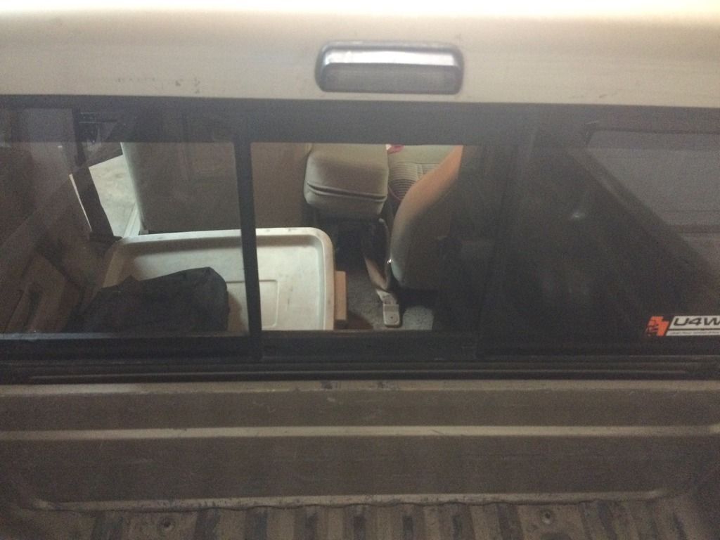

I removed this guide on top and bottom. This allowed the window to slide in further on top, then the bottom had enough clearance to slide in. Easy. Then I held the slider up and slid in the bottom plastic guide. Then held the window down and slid in the top guide. $20 junk yard slider saved me $300.
Looks good!

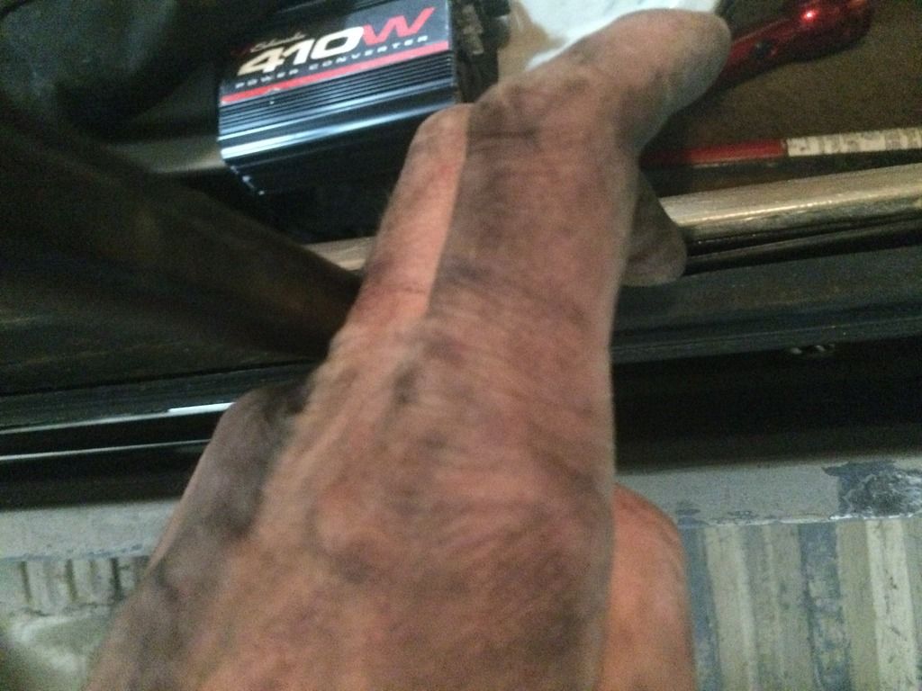

When I got home, I pulled out the plastic guides on top and bottom. You can see the bottom guide here:
I am removing the bottom guide with my grubby hands here
