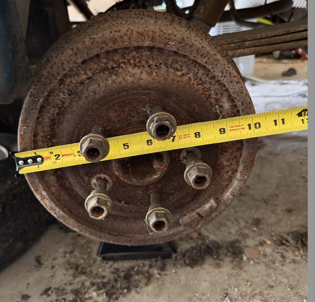

As I'm waiting for the bearing grease packer tool to arrive to move forward on the front discs, I figured I'd start on the rear drums. The unfortunate thing is that the drums are stuck on and will not spin while the truck is in neutral which leads me to believe the brakes are seized. I sprayed PB Blaster on it and tapped with hammer to get a vibration going, but any other suggestions to remove them would be appreciated.
On a side note, am i right to believe that these are 10 inch brakes? It's an RWD but they don't look like 9s.

I hate asking this; is the parking brake not engaged?
If "yes", you can stick a long prybar where your tape is (lugnuts on the studs), and see if you can turn the drum. Both back wheels are off the ground, right?
Usually the damn drum is rusted to the axle flange. See if you can get it to rotate first, then deal with breaking the drum loose.

The one you show looks pretty crusty. Hopefully you're going into them to replace everything.
Keep hitting them with PB Blaster, and it'll take time to soak into the areas that are rusted together.
Once you can spin it, those silver retention clips have to come off to pull the drum. They can be driven off, unthreading them, with a punch and pliers if you're going to reuse them. I don't think that they're actually needed; I've always thought that they're just there as part of the vehicle production process to keep the drums on before the wheels were installed.
