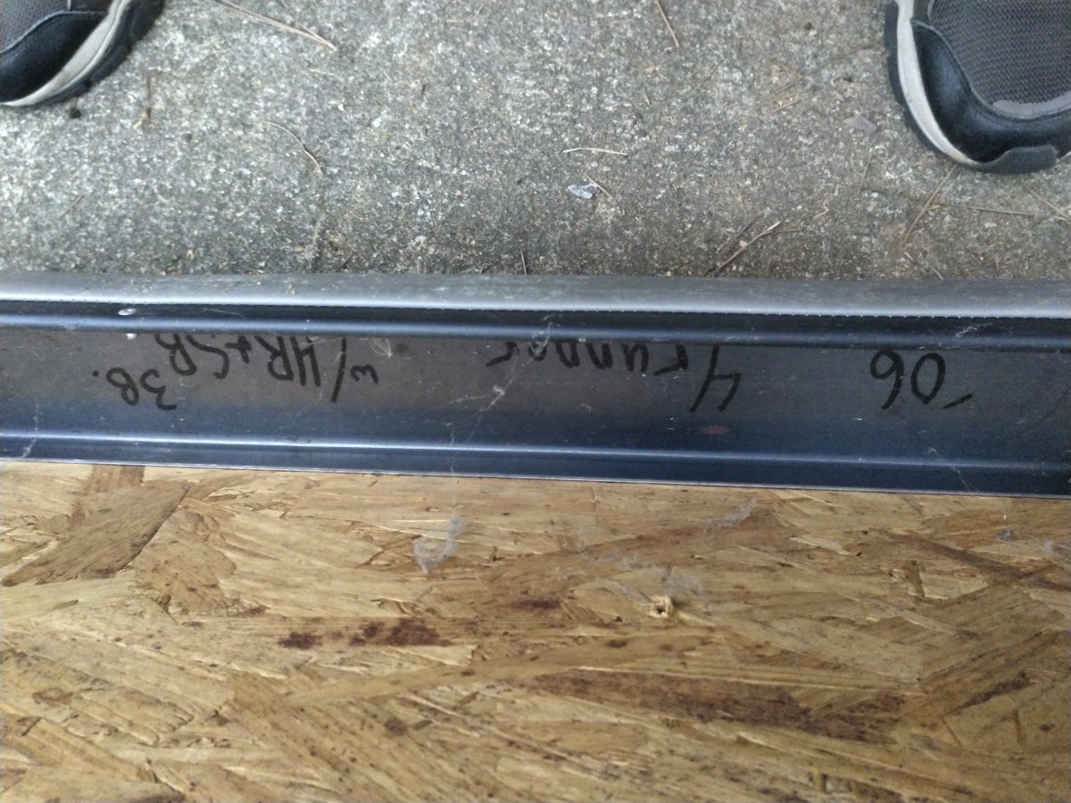

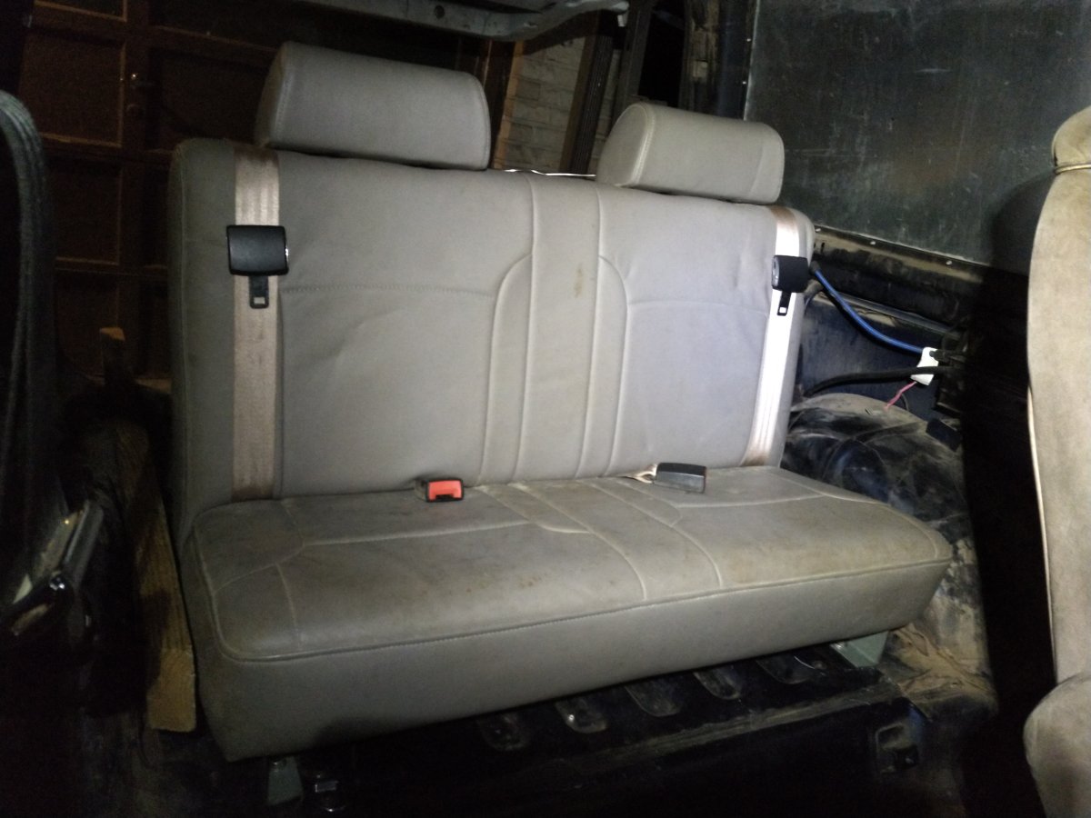

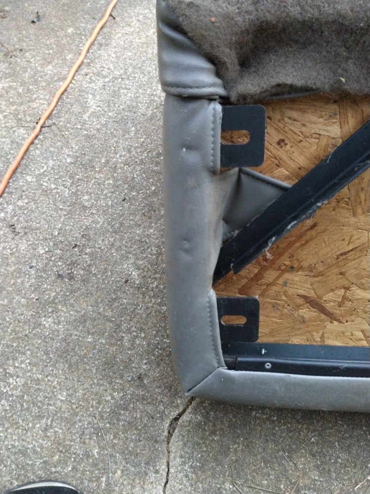

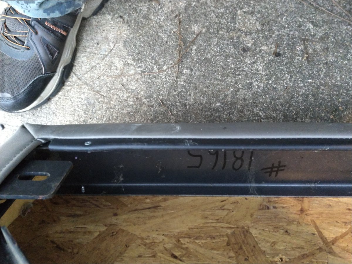

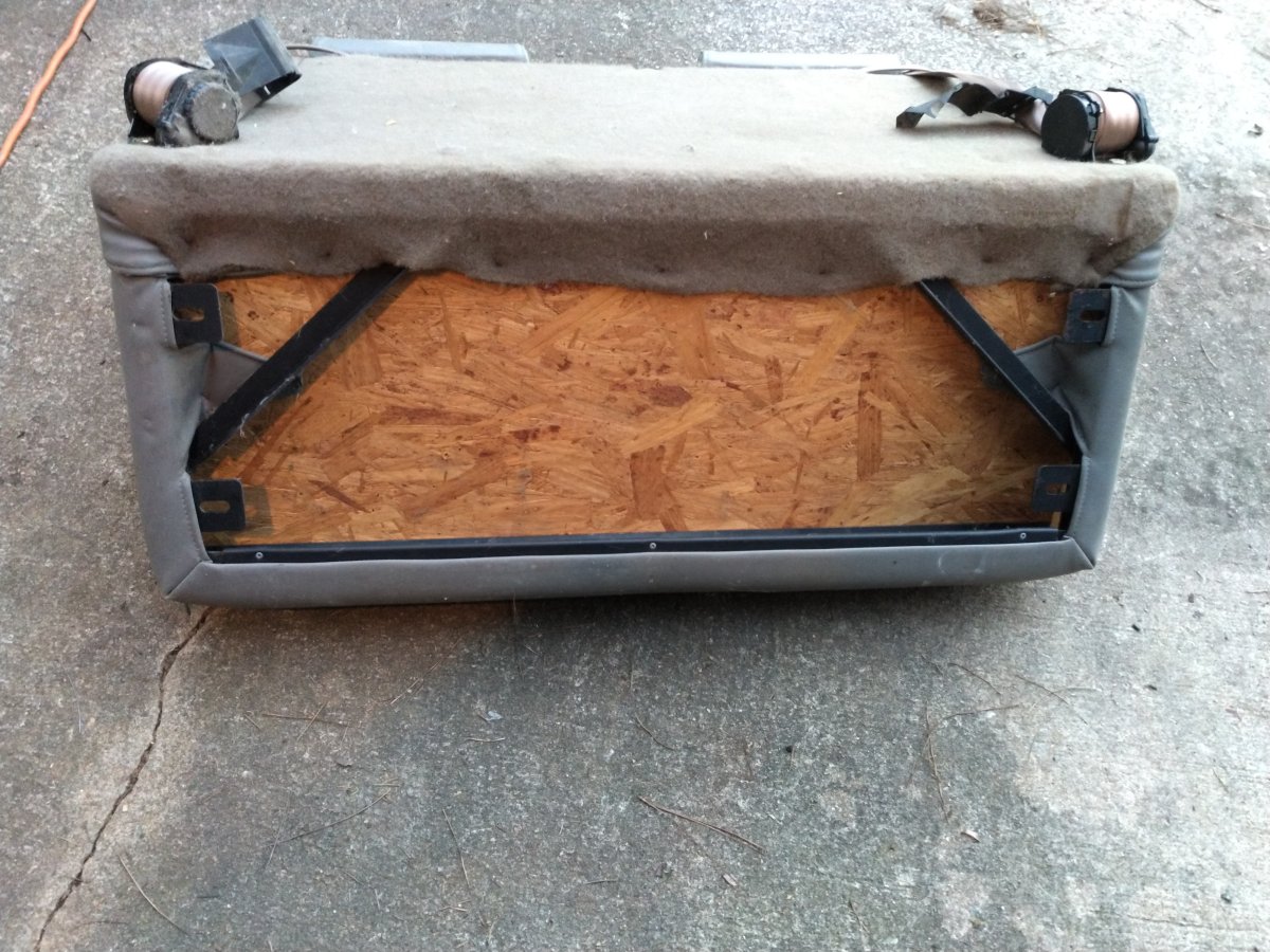

I tried putting rear buckets in (from Aerostar, Alfa Romeo, Chrysler, etc.), they just did not fit correctly, too cramped, so, I went back to a bench seat, I tried various bench seats too. I posted pictures elsewhere of my most recent install. I wanted shoulder harnesses too. The seats are installed on 3" structural channels and bolted with grade 5 bolts and grade 8 on the floor with plates and washers. On some bolts I used the factory holes, on others I drilled.
