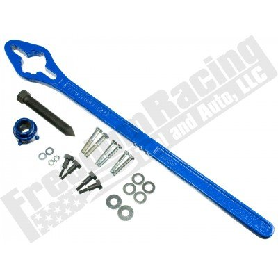

I have the OTC Big Blue Bar. I've had it for years... don't remember exactly what I paid but today's price on the only one I could find in stock is north of $1000. WTF!!!
