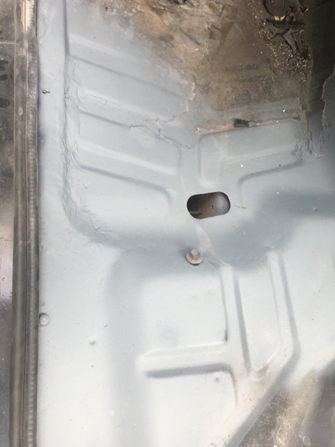

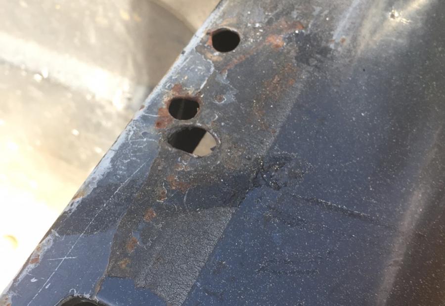

As I alluded to Ive been doing a lot of body work so far. I welded the new panels into the floor and am filling holes along the bed where I think a canopy used to be. I really enjoy working on auto body (had plans to do it as a living at one point but life changed) so its been fun to clean up the surface rust and get the little dents out before it eventually gets painted.

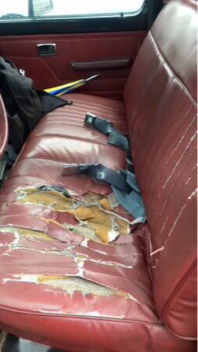

Eventually Ill be getting better interior parts. The bench seat looks like it was fed up with being sat on about a decade ago.

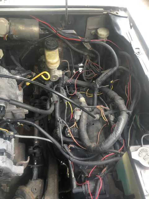

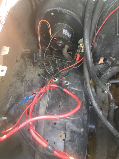

I need to figure out a wiring issue on the firewall. Looks like instead of putting connectors on the wires for the fuse box someone just cut a bigger hole :huh::dunno: So I have to fix that at some point.

I've mostly been working on the body and patching the floor. I still have some welding on the transmission tunnel to do And I'm debating if I want to cut it out and put make a new tunnel whenever I can. Figure that I just need to seal it up from water for the time being.

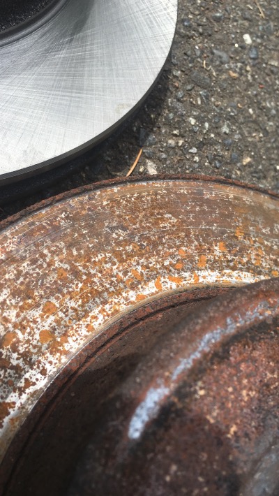

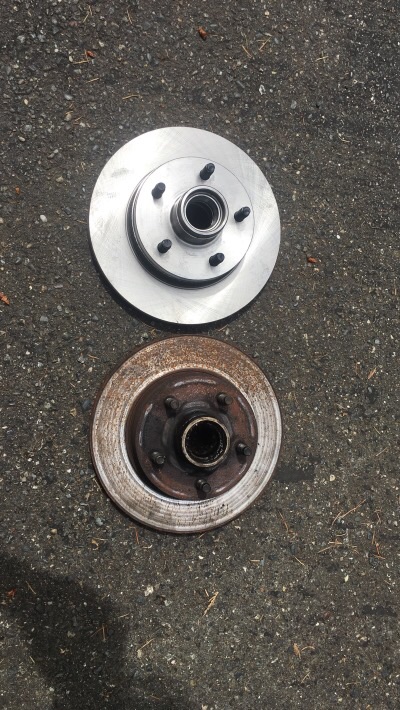

hopefully you can see just how bad the rotors are in the photo. Really deep groove in them both. It's just time

My bench seat. Think that'll buff out?
I took the seat out when I realized there was a good amount of rust on the floor pans. I've been able to grind and paint away without worrying about setting the seat on fire (only way I could possibly make it worse). Eventually I think that I'll replace it.

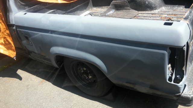

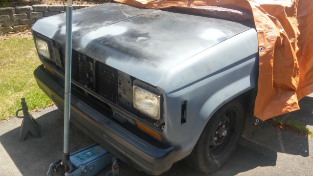

Updated pictures to come soon. I've done a lot of body work whenever I've had time. There's been a good amount of rain every time I start so it's been slow. It also looks nasty right now since I haven't really gotten all the paint smooth before putting primer on to cover up any bare metal
Here's some of the progress I've made in the body work lately. Right now I've been using the Krylon Rust Tough primer whenever I'm done for the day. I still have a fair amount of dent smashing to do.
My plan right now is that when I get into school I'll be using Por 15 primer on this. Not sure sure what color it will be in the long run. I'm thinking either a semi gloss black or a dark olive drab

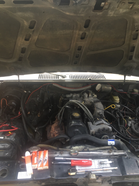

I changed out the oil, filter, and plugs today. It was the first time I had gotten a view of what the inside of the engine is looking like. The plugs looked like they weren't too old. No real discoloration or imploded anything. There was a bit of what I think is broken down anti seize. Was kinda oily and only on the threads. Not thinking it's much since it's not on the diode or anything.
Was similar story with the oil. It was really grimy but it was smooth with no sludge or derby. Just dirty.

Oh yeah, my wiring is a rats nest. Not sure where a lot of it goes but I'm sure it'll be fun [emoji15]

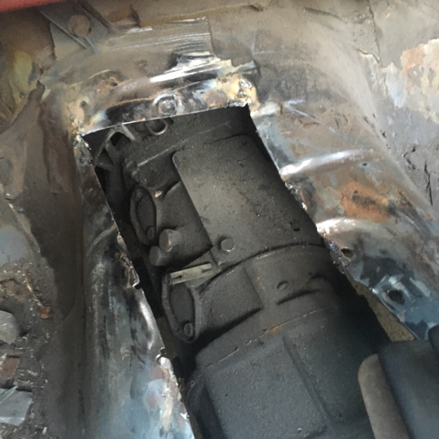

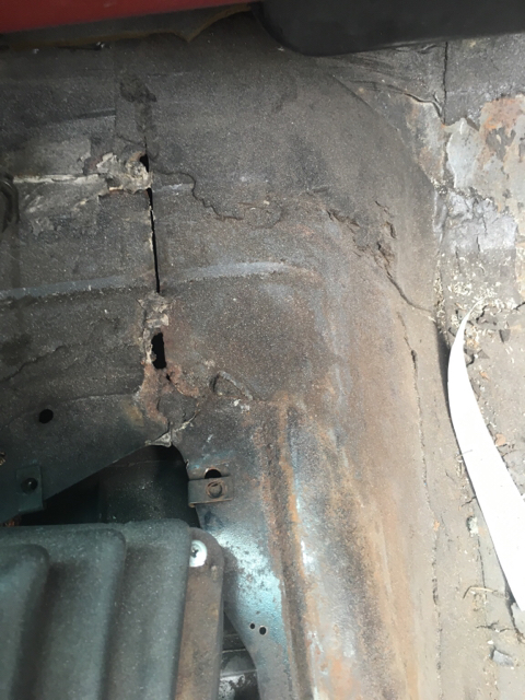

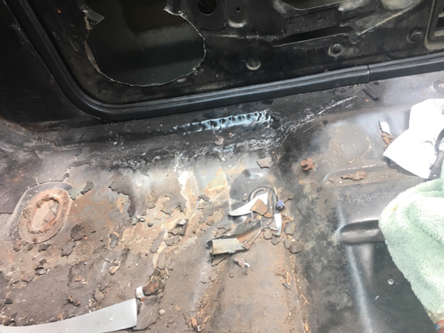

Here are some pictures inside the cab. You can see my lovely patches. Those may get pulled out at some point but I was going for functionality. I just put some basic sheet metal in and used fiberglass filler to cover.
I'm not sure what to do with the transmission tunnel still. For whatever reason someone decided that it'd be grand to cut lines along it so those may either be getting patched or I'll replace parts of the tunnel itself.

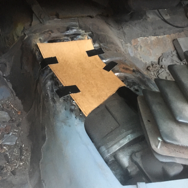

Decided yesterday to tear out the patch one of the previous owners had done. It was a pretty poor job. Not welded all the way around and to seal it they used liberal amounts of crappy household caulking.
Started fabricating a patch (the old metal was trash. Someone thought burning through metal while welding was acceptable. Didn't get much past making up a cardboard template.

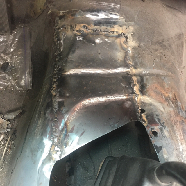

I finally managed to eek out a day to cut and form the patch. I'm pretty happy with it considering I don't have the proper tools and experience. Much better than my first patches and welding.
I'll go back and finish up the welding. There's still a couple holes to fill up and smooth out.
