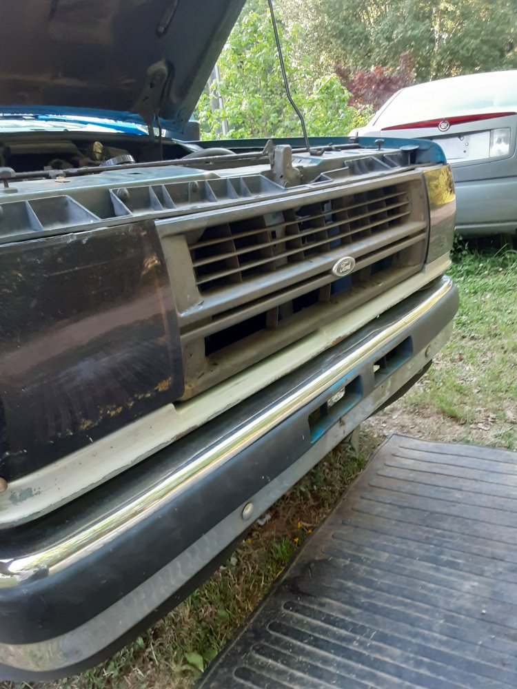

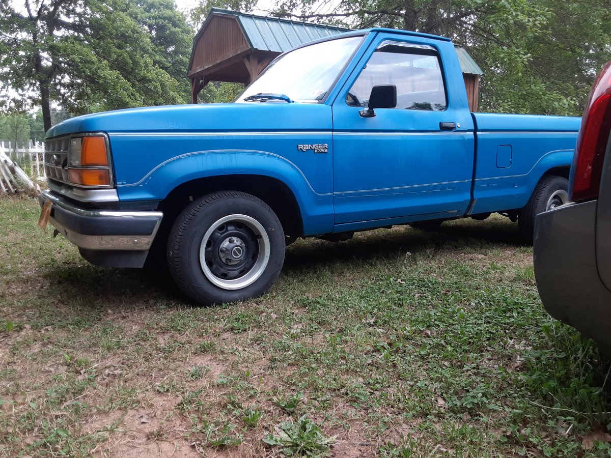

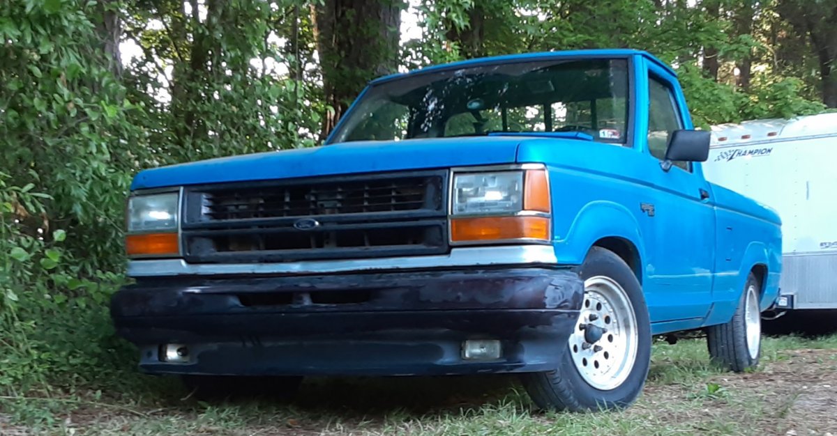

Picked up this ranger about a month ago 2.3 5spd, Actual 130k truck! Have some explorer limited parts and gonna do a Ranger version! First pic is how I bought it. Slapped on the grill. Then lowered it cut 1 1/2 coil off front installed concentric bushings, shackle/hanger flipped rear and fitted the bumper on, though it's not adjusted yet because I have a straight filler panel I have to put on... more to come hopefully soon!
What model year was this truck you picked pls?

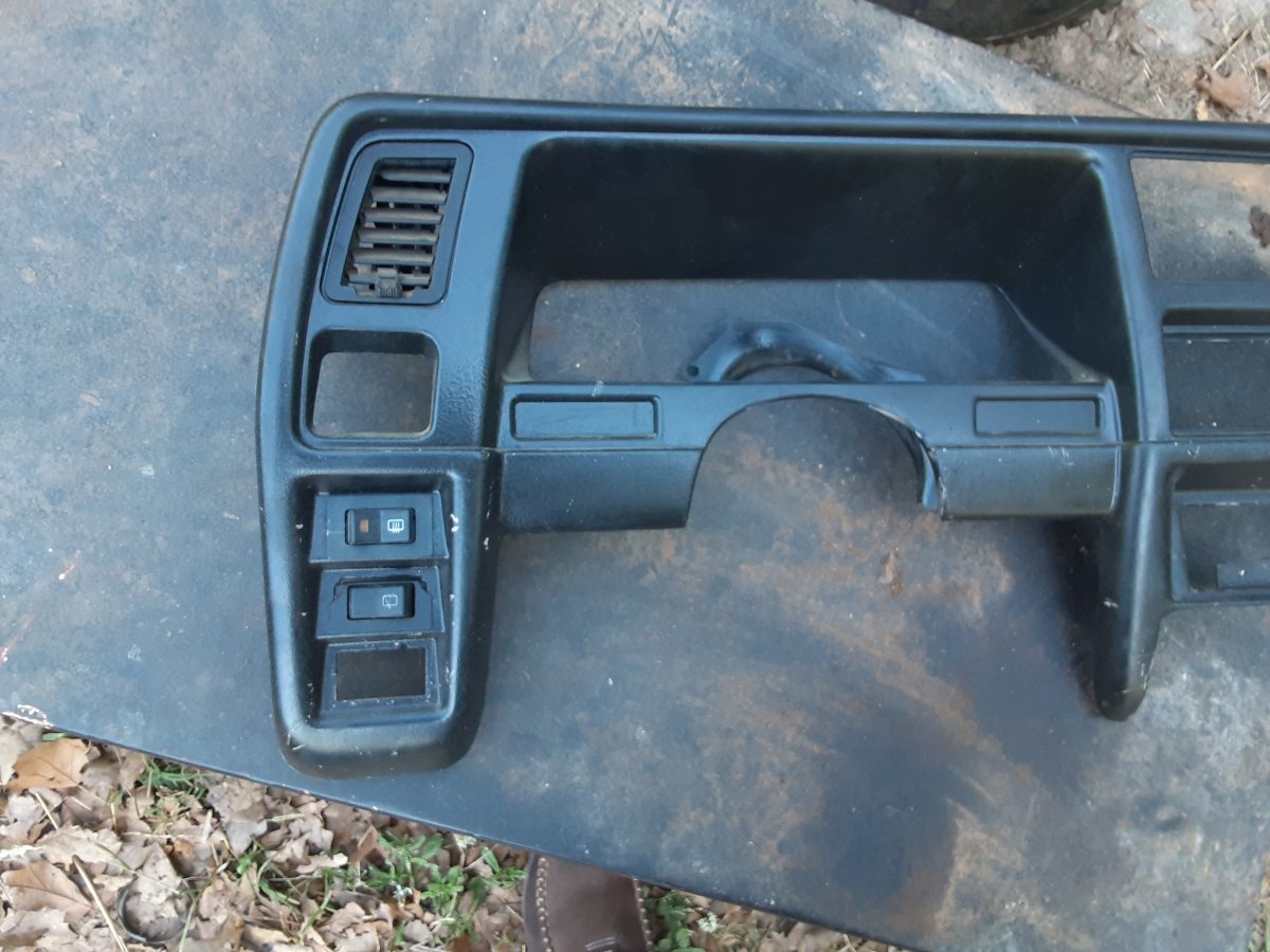

91-94 explorer limited... if you get front bumper you should get the gauge trim(not sure what to call it) because it has provisions for fog light switch! Also have to use ranger bumper brackets or modify the explorer brackets
This thingy here

Is it possible to swap parts of off an explorer with a 4.0l engine? I meant, stuffs like the side mirrors, rear lights, seats, front ends, etc?
Mirror rear lights no... dont think fenders will work either bit not sure . Hood headlights grill bumpers seats(with your ranger seat tracks) and dash stuff should all fit with very little or no modification!!
