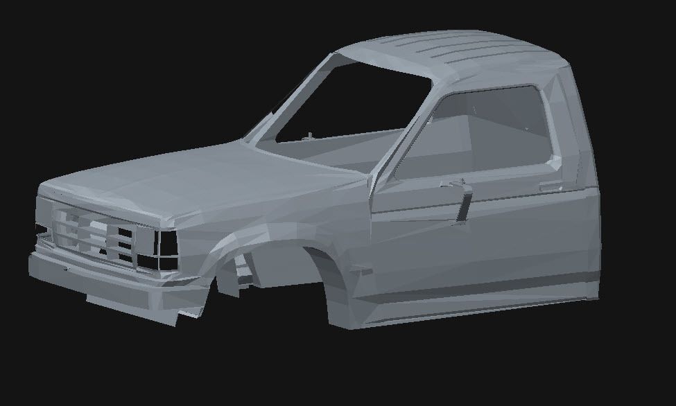

After looking around for some time I was reminded of the formerly know, Google Sketchup, now just Sketchup. Downloaded it for free and looked through the library of models and found a decent 2nd gen ranger. Made some modifications in sketchup and exported the file as a .wrl. This file format can then be opened in actual CAD software, Solid works, Cero, ect. I use Creo 2.0 at work and thus at home for government work.
The only thing with importing the .wrl is that it renders a faceted dummy surface that can not be modified. Thus, modifications must be made in Sketchup before exporting .wrl file. But it does give a good visual reference.
After pulling measurements from my actual rig and setting up my model skeleton for designing the cage the Ranger reference was scaled appropriately. Cross referencing points on the Ranger reference and actual real world measurements verified the visual reference is very close to actual.

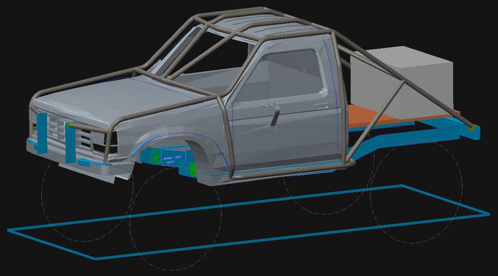

So here is what I have so far.

Assembly skeleton. Solid datum features, datum lines, planes, points, coordinate systems, ect. A lot of this is not shown in this picture. All data pulled from my actual rig.
Ranger cab imported from Sketchup.
Full assembly skeleton and cage.

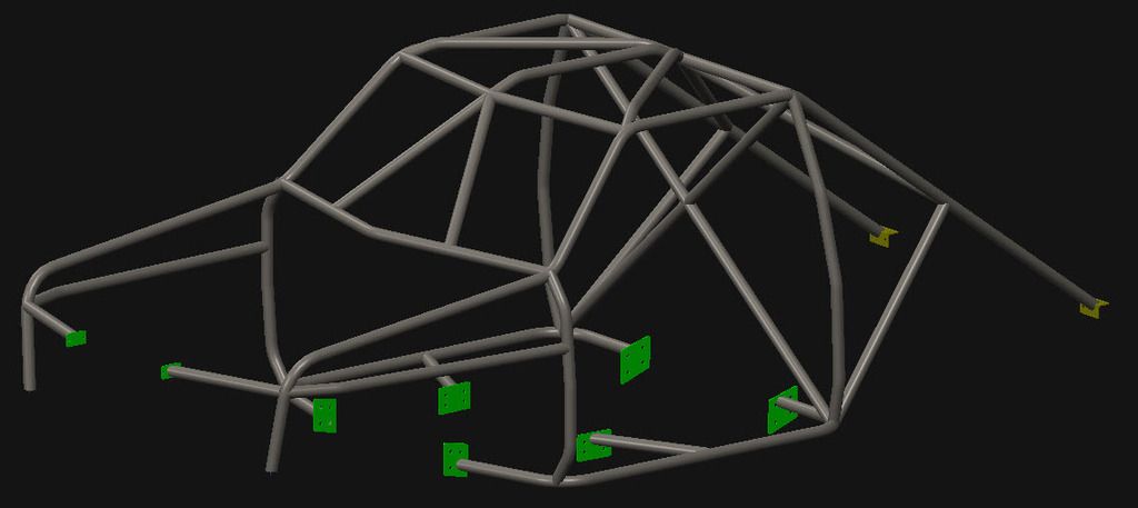

Just cage.

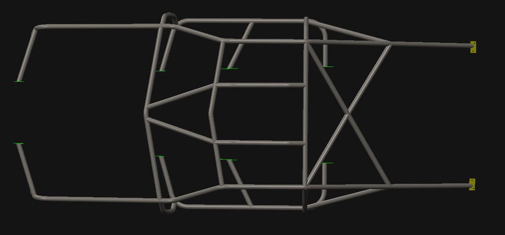

Top view
Tubing is 1 3/4" O.D .120" wall DOM. All bends 6" radius. Green details are laser cut tie in plates. Cage will bold up to front winch verticals and rear bumper. As I want to keep the front winch and rear bumper removable. Frame tie plates will be plug welded and perimeter welded to frame, with tube being welded to them. Theoretical weight is 230 lb.
Still need to work on the tube doors. Want to have a swing out tube door that will retain full function of the OEM doors. A few more runs of tube my be added for more front end body tree sliding ability. Also depending on FEA results tube structure may change a bit.
Cant wait to start building this summer:icon_hornsup:

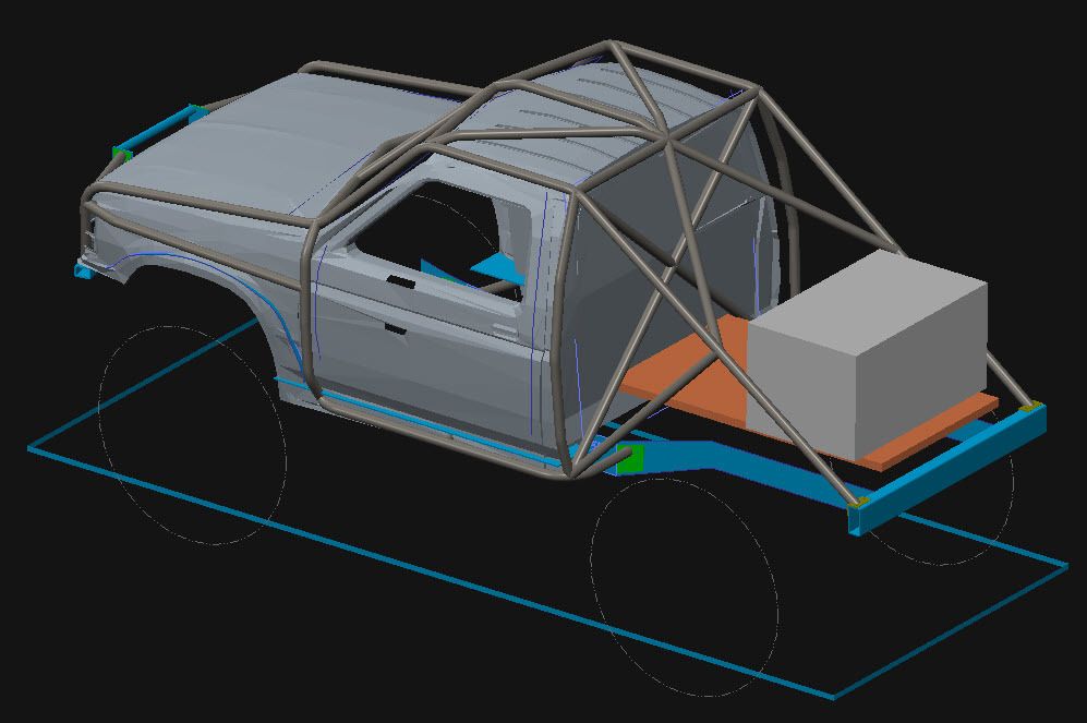

Update.
This is what I currently have. Theoretical weight, 270 LB.
Still need to work out the tube doors................
