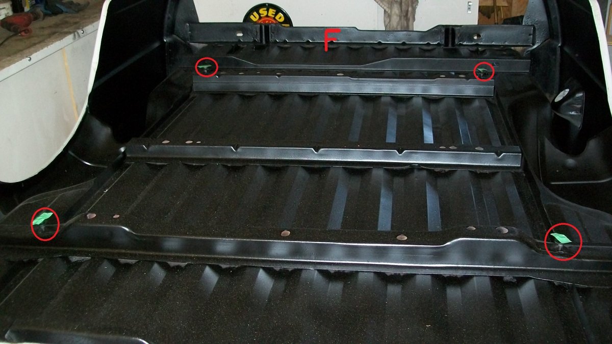

The reason for this post is to ask if anyone has had any experience with some bolts underneath the bed. I am NOT talking about the six mounting bolts that connect the box to the frame.... I know all about them. When I got the box there were four smaller bolts installed. I removed them, cleaned them on the wire wheel and put them back. I have no idea what they are for..... Can anybody give me a clue about these four bolts? I have watched several You Tube videos about how to remove a Ranger bed and not one of them says anything about these four bolts. I will look under my Ranger to see if there might be some purpose for these four but ???? I am looking for the definitieve answer or some guesses.... All thoughts are appreciated.... Thanks PS... I attached a picture of the location of these four bolts and added a piece of green tape on them so you can more easily see their locations.... and the letter F for the front of the box.... and just remembered what two of them are for I think.... aren't they for the support rods that are incorporated with the rear mudguards that hold the rear quarter parts firm? If so, what are the two front bolts for?

Just a guess here...
With a body lift it's common to use "gap filler panel". Maybe those bolts held that filler panel in place?

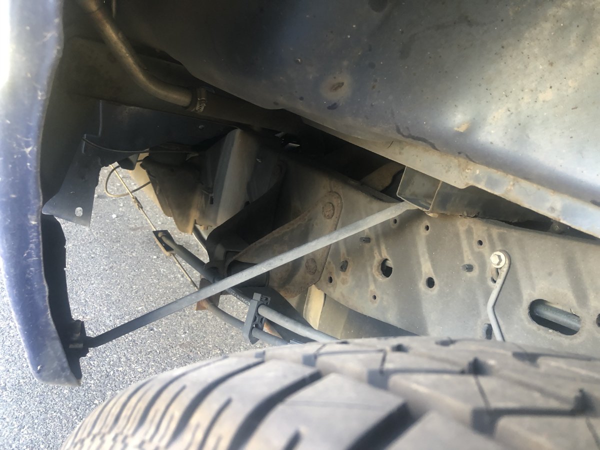

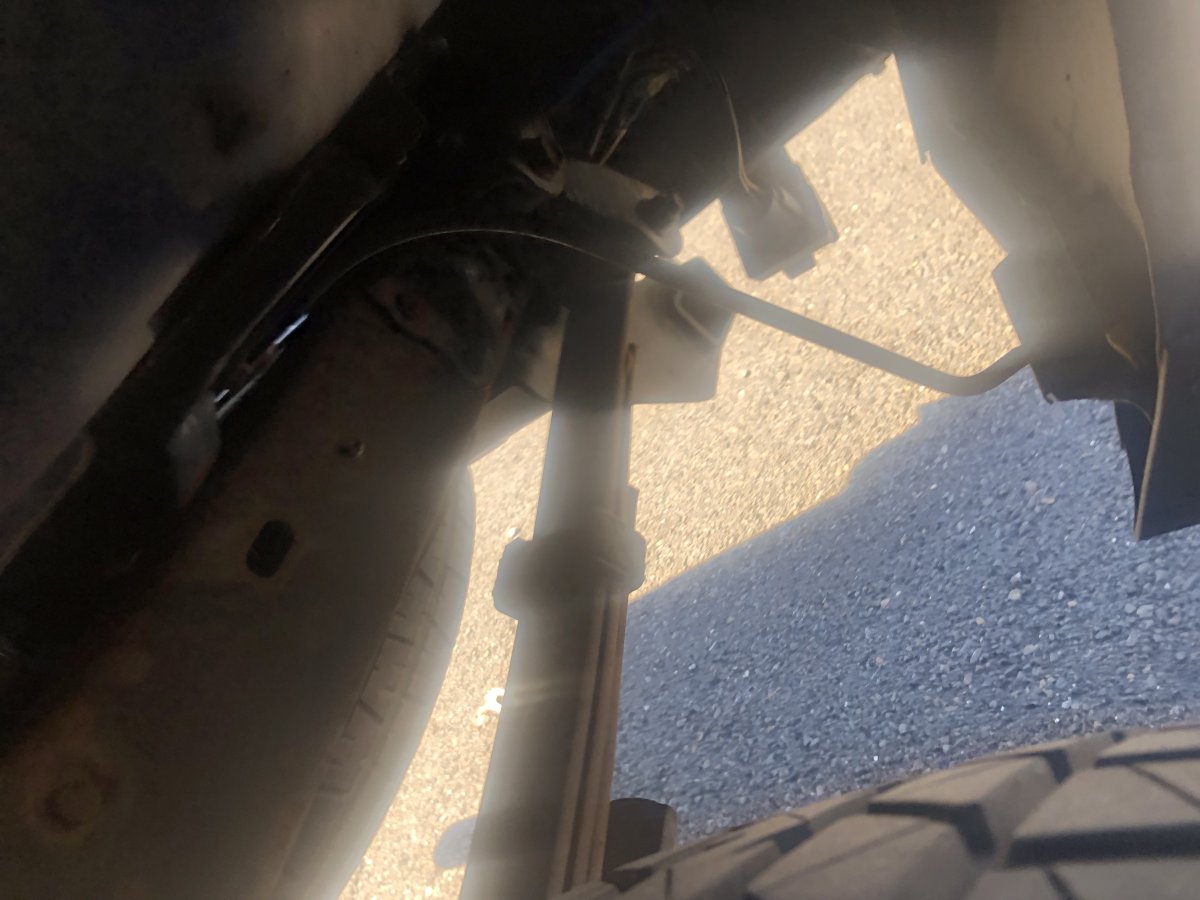

There are supposed to be four metal bars/straps that attach the bed sides to the bottom of the bed to keep them stiff. My assumption is that is what these four bolts are for, they look like they are in the correct place.
I have the ones I took off my 2003 when I swapped beds.
I can go and take some pictures of the underside of my 2011 later if no one shows up with something more concrete.
Front
They clip nuts to attach to the bed side.
Hey.... thanks to everyone.... and after I sent the message I went out to sand some more paint and while doing this mindless work I kept looking at the locations of the bolts and I knew the back ones that also work with the mudguards, were removed making the rear panels kind of weak/floppy.... and then looked at the location of the front ones and assumed that there must be some there too....
