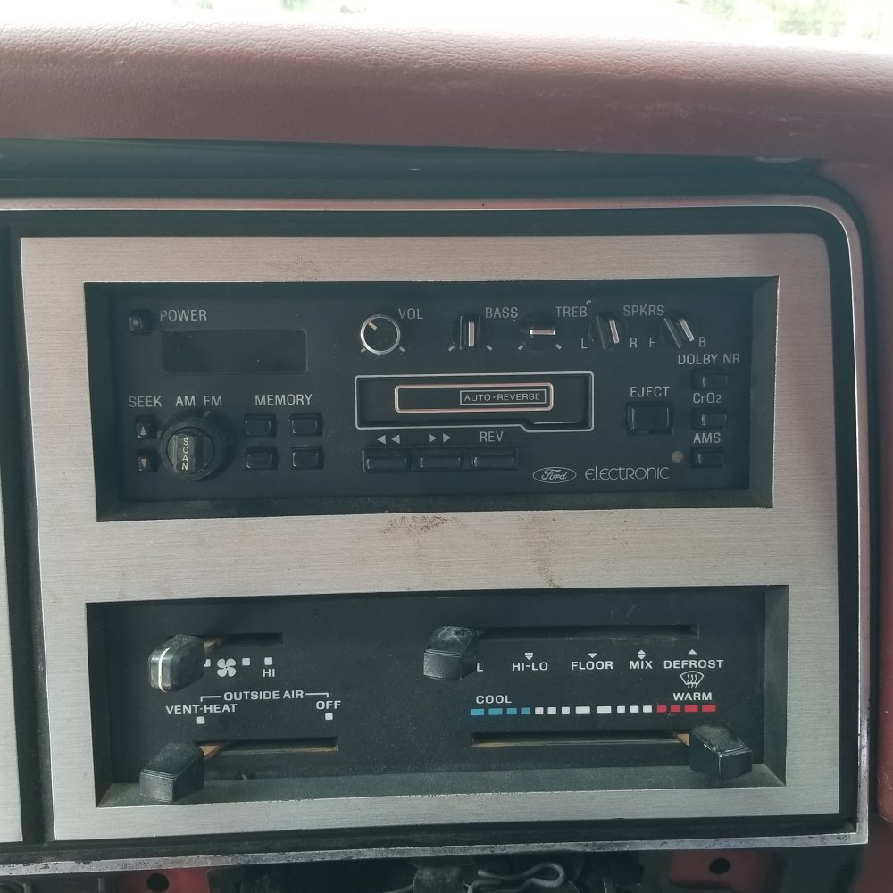

Im replacing this radio...
With this radio...
In my 86 B2.
The "new" radio is also an 86 (part number begins with "E6")
I read that all radios from this era are wired the same?
Reason i ask is the new radio has similar, but different color wires then the truck harness, and there are only 4 speaker wires...truck has 5. (Not sure why...only has 4 speakers)
I ordered the crutchfield splice on connectors so i dont have to butcher the truck harness.
My question is...are they indeed wired the same just different plugs? Would the wires on the radio appear slightly different color due to fading or something?

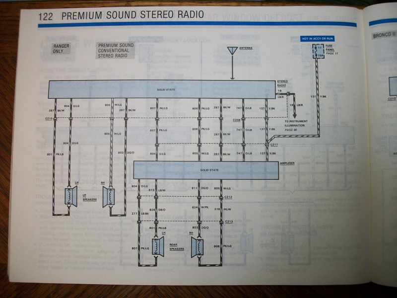

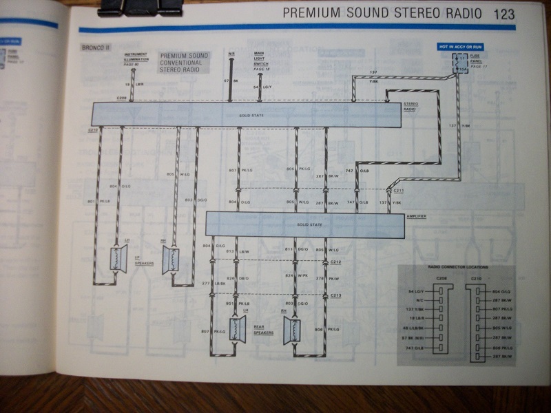

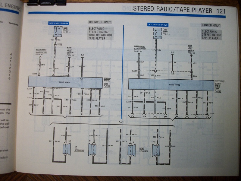

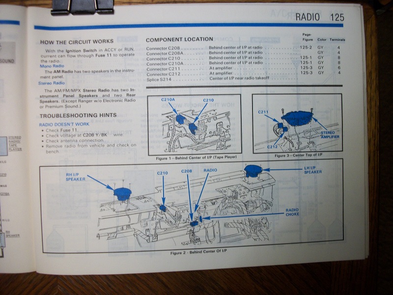

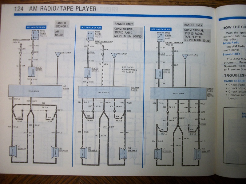

Here are all of the radio pages out of the 1986 EVTM. They do note where there are differences between the Ranger and Bronco II.
Just make sure that you don't have a Premium Sound head in the mix.

Ill get pictures of the plugs when i go back out to the old house in a couple days.
But the non cassette radio has the newer style long flat plug. The cassette radio has big square connectors that kinda look like the ones on the fenderwell under the hood.
I know the non cassette isnt premium sound. I doubt the new one is either. Its got pickup truck mounting brackets. IIRC it came out of a big bullnose bronco.
Definantly isnt the same plug lol

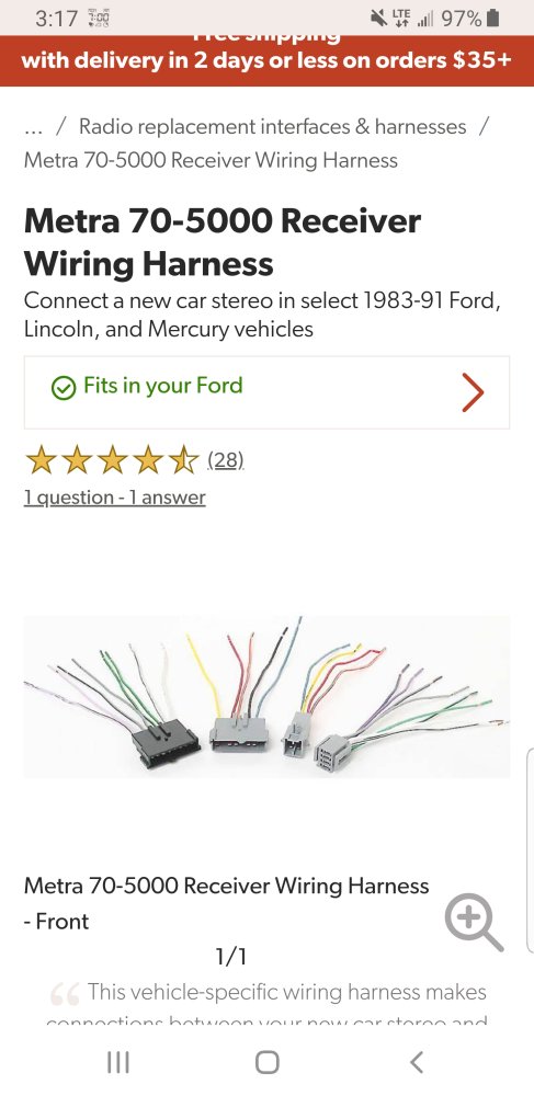

It sounds like you will need to make an adaptor using a Metra 71-1772 and a Metra 70-1770. I say Metra because that's the brand that has the model numbers, I'm familiar with. The 71-1772 will plug into the back of the cassette player, and the 70-1770 will plug into the Rangers factory harness. Take a look at those harnesses and see it that is what your radios plugs look like.

heres what i ordered. Its got both style plugs in the kit.
There is some variation in color. You should be able to tell more when have the parts together though.
That's the basic color scheme for aftermarket stuff. Notice the Illumination (Orange) and 12V Constant (Yellow) look nearly identical in this diagram.
Edit: I just noticed the left and right front both look white here too. One of them should be gray.
