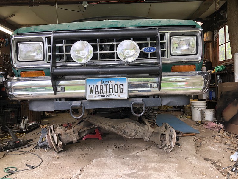

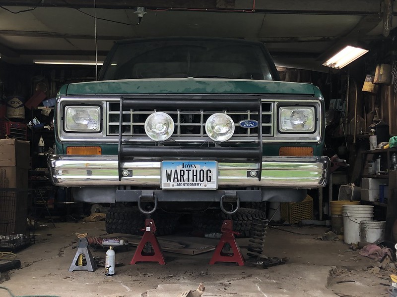

I didn't monkey with anything, just dropped the D28 out.
Three years later I remember fighting to get heavy unbalanced D35 in a lot more than getting the D28 out.
Holy earthquakes @85_Ranger4x4
I think you might want to patchwork on you garage floor. Or better yet... lay a new slab. LOL That can't be fun for your floor jack.
With enough momentum you can move mountains :icon_thumby:
My garage floor looks a lot like that. You'll be surprised what you can do as long as there isn't weight on the jack and a piece of zip tie laying in the path you want to move...
