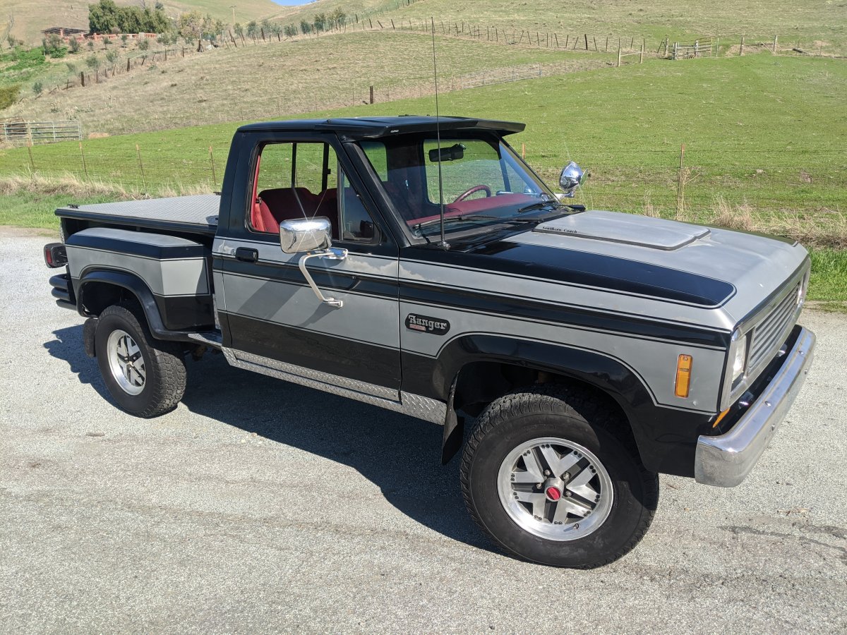

Would be awesome if you could find this style if aftermarket stepside bed. I think Southern Coach made them.
That would be the ultimate goal. I've seen a stepside s-10 from the same era that looked VERY similar.
Eons ago there was a truck on ebay, the guy narrowed the factory bed and used dually fenders to make his own stepside.
