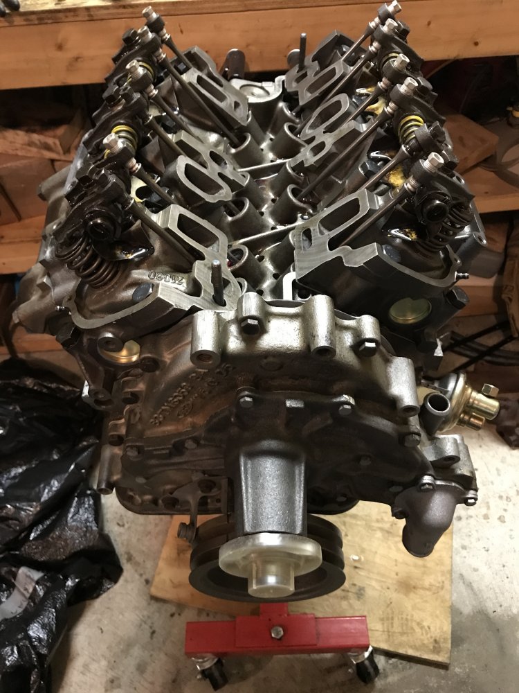

Your adjusters look like this, and you’re out of adjustment?
You’ll have to pull heads to get the lifters out. When I removed mine, I couldn’t get them out from the top, once I removed the cam I had to drive them in and fish them out through the cam tunnel.
Thank you for the excellent picture. Yes, mine look just like that and same lower thermostat. I am out of adjustment and they are cranked all the way down. Two others are cranked down, but, they are barely making the .014 and .016. I do not see how the push rods could not be seated and still be making almost 150 psi cold, though maybe they are bent? I hate taking the covers off again, I just put a new set of valve cover gaskets and they do not appear to be leaking at the moment. I did double check the lash adjusters to make sure I was adjusting them on the correct stroke and went through both sides twice using a check list. Then I did the compression check.
