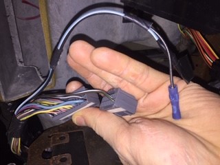

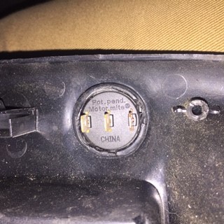

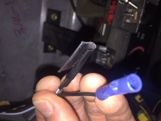

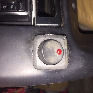

That makes sense. I'm missing other fuses and relays but thought I'd mention it just in case. I'm attaching some pics of what I came across today, hopefully they'll help explain what I'm working with.

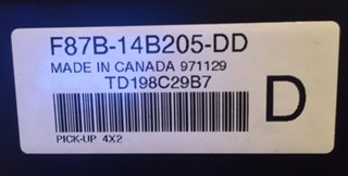

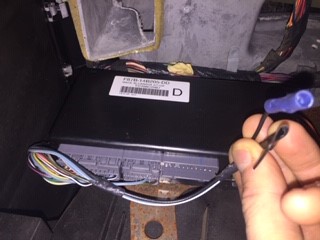

First I removed and sprayed my GEM with CRC QD electronic cleaner, and I'm allowing it to dry over night just to be safe. I also sprayed the electrical connectors that plug into the GEM. I noticed I only have 3 total connectors that plug into my GEM, while other videos show a total of 4. This could be because I have a 2wd vehicle and the fourth is reserved for 4x4's or some other option I don't have on my vehicle.
There are two wires coming from the same location as the rest of the GEM wires that have been removed from somewhere. One has an old crimp and I tapped the other because it was bare when I found it. These look like they could reach an aftermarket switch (I think for aftermarket fog lights that don't work) which replaced the factory cigarette lighter. Or, maybe they are supposed to go to my GEM? Not sure.

I got the GEM hooked back up after spraying it down as well as its connections. I'm going to preform another parasitic draw test on my battery today, but I'm thinking this is my problem. Should there be another connection here?
Can't say I recognize that exact wire
Ranger wiring harness can have many unused wires for Options that were not selected by original buyer
