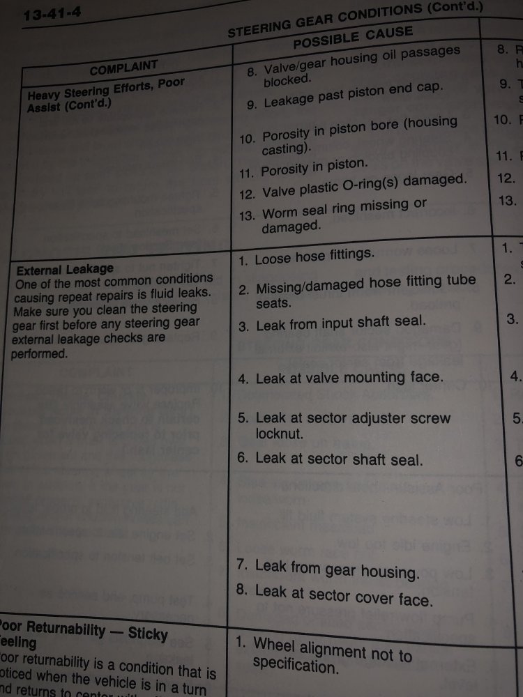

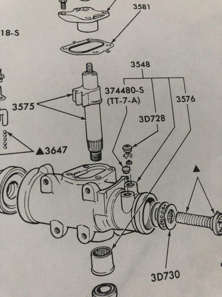

Let’s take a step back from replacing the gear box. The o-ring goes on the high pressure hose to pump connection. Going to the gear box, we have the hoses and two tapered seats. The taper seats, if present and damaged (vs missing) are replaceable.

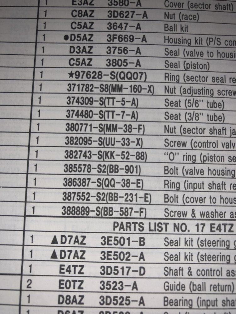

If we take the part number for the pressure seat and check rearcounter.com, green sales company has 66 of them.
If you want to replace the return seat, that can be found here:

I may have had the pressure and return seat part numbers flipped. Maybe 5/6” is supposed to be 5/16”—which would be the smaller, pressure hose.
