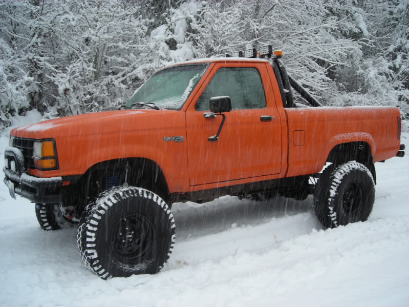

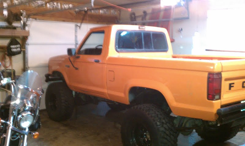

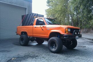

has a 4.0l 5 speed, 35 front with a locker 8.8 31 spline rear with a limited slip, 6 inch suspension lift 3 inch body, 35 x 12.5. on 15x 10 soft 8's, factory custom truck. was a San Fransisco city maintenance truck. thats why the orange and yes that is a factory paint job. has extended radius arms homemade, and james duff coils with 2 in pucks, the rear is (i think) explorer leafs, and it has shackles. the truck flexs like crazy i was amazed. tell me what you think

nice looking ranger man
nice ranger but are you 100% sure thats factory paint?
If that's a factory paint job, It'd be the 1st time I've seen it (not saying that your lying or anything). Plus, for being a city maintenance truck, they must of taken pretty good care of it..Looks really good!
Any plans other than what you've already done?
yea i am 100 percent sure that it is factory. its got 205,000 miles on it and runs good beside a annoying lifter tick. i put new rocker arm assemblies on it and that didn't help so i am for sure that it is a lifter. i want to sas it with a eb front end. with air shocks. and do a efi 5.0, 5 speed swap but not sure if it is necessary cause the 4.0 has plenty of power with 4.56. just annoyed of the lifter tick and lifters are around 50 dollars a piece, plus gaskets so your looking at 600 plus.
