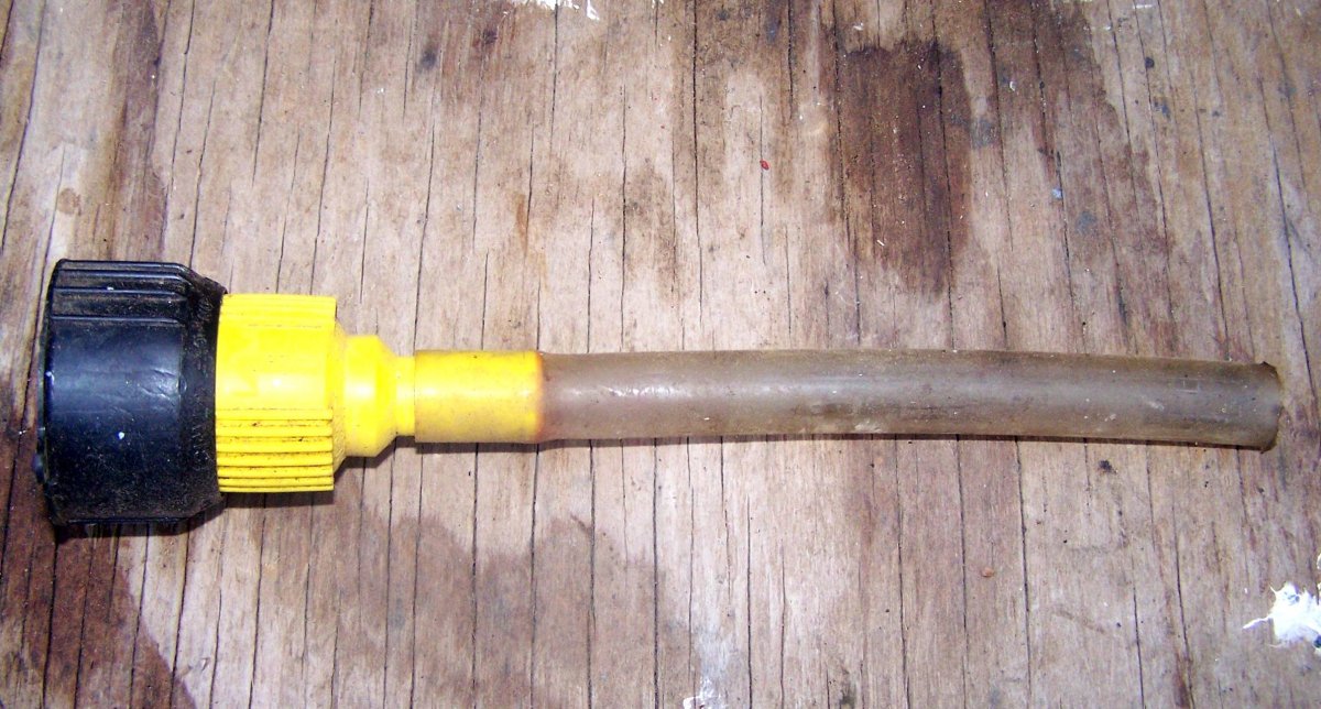

Near forgot, here's the little oil filler tube I last used 12 years ago. It came with a longer hose which I shortened to make it easier to fill the transmission, just hold the bottle upright and twist the end of the hose into the filler socket and then ease the bottle up until it goes in. That yellow thing also twists to shut and open a valve. It worked ok I guess but thinking there was some leakage. I also think it fits the rear axle oil bottles

No problem Pentax, hope it helps. I edited in the photo of the other filler method I know of into the post where I was discussing it earlier
