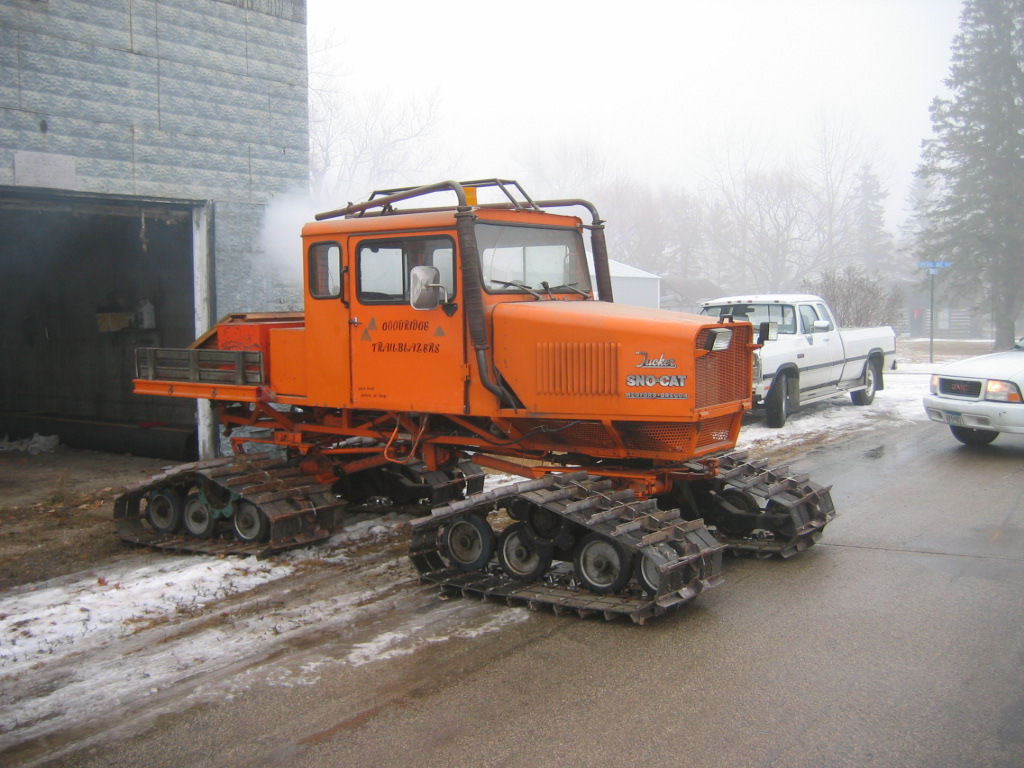

This is a tucker sno cat, my boss uses one every winter for hauling fuel, and it actually uses Dodge running gear, some semi tractor parts and a few other things for its undercarriage. It has the same kind of tracks as the thing above.
If you could separate the right and left brakes on your ranger, they would steer you. You could probably use your original tires, and a track system like the first machine I posted. Use trailer tires and axles as rollers? Itd be bad ass, and Id love to live my dream out through someone else.
