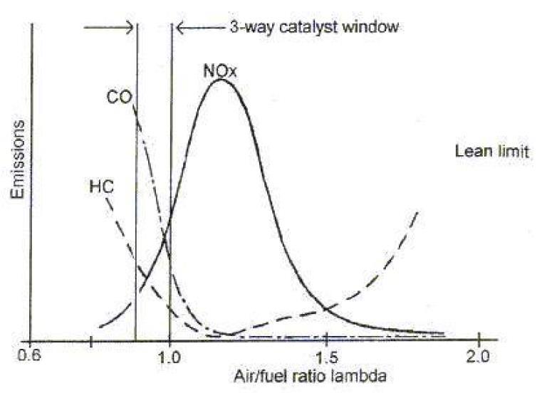

My understanding of the system is that it is comparative. The system looks at what is going into the catalytic converter and what is coming out of it. So both perform a function.
A higher octane does help to a point in some situations but is a band aid and costs you more money in the long run than addressing the real issue or issues.

Higher octane makes the fuel burn slower which makes it burn a little cooler which as explained earlier could lower the NOx output
