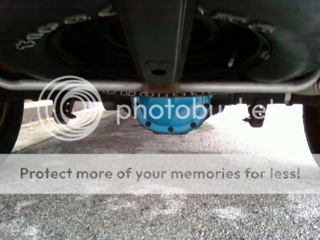

i would just do black axle and then paint the diff cover something different. i did the one on the ranger with some left over ford blue and i love it. really stands out
