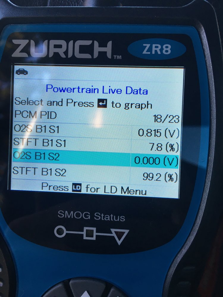

Tested the o2 with my scanner and it’s showing b1s2 never getting any voltage?
Would this cause issues with bay 2 even though it’s bay 1?

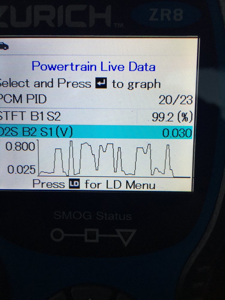

The bay 2 s 1 averages .5v at 1500 rpm
But with many spikes and drops as seen in graph
That's normal. Upstream o2 sensors constantly switch from rich to lean as the fuel trims are adjusted rapidly. The downstream sensors should remain consistent.
