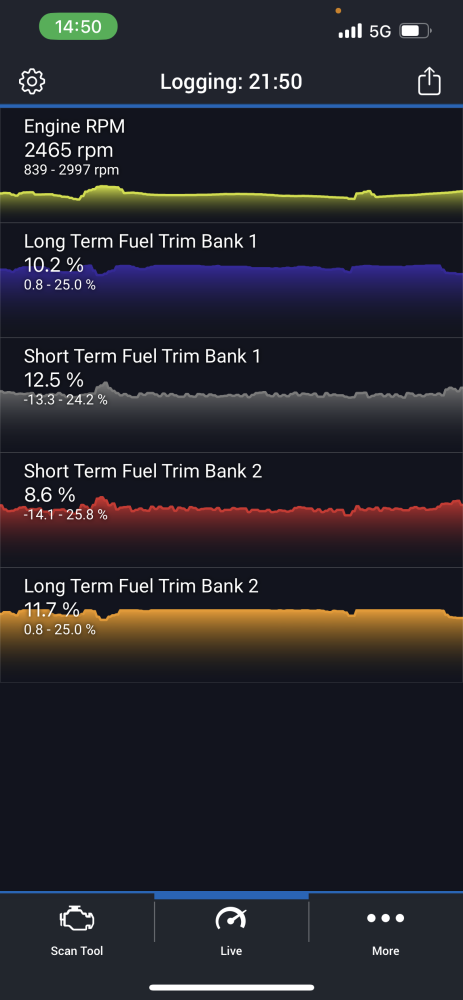

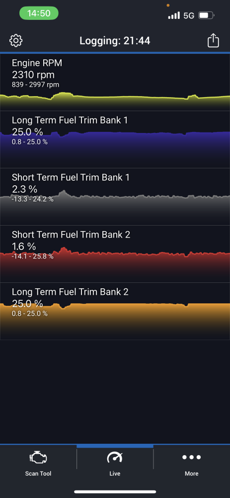

My truck has been throwing 0171and 0174 codes for running lean. My initial research suggested this was a vacuum leak, but I think it might be a fuel delivery issue, as the long term fuel trims really get lean during a period of acceleration.
My STFT seem like they’re in good shape, but at about 2300 RPM while accelerating my LTFM shoot and max out at about +25. STFT look good at
At about 2400 RPM at hard acceleration both the STFT and LTFT tend to sync up, to about + 10. I don’t think is lean enough to throw a code

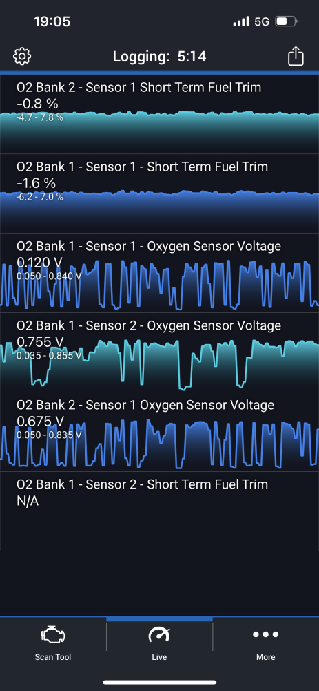

I’ll have to my OBD2 sensor with the fuel trims, but the Bank 1 Sensor 1 voltage seems suspicious. Should it be more or less the same as Bank 1 Sensor 2?

No
O2s only see Oxygen, and only when they are heated above 600degF
High oxygen is lower voltage, 0.1v
Low oxygen is higher voltage, 0.9v
O2s generate their own voltage, but are Heated by a 12v and ground wire
O2s closest to the engine are "sensor 1's", upstream
O2s after Cat converters are "sensor 2's", downstream
All the same sensors, just different locations
Computer tries to keep Upstream sensor 1s between 0.2v and 0.6v by changing the open times for fuel injectors on that bank of the engine, so Sensor1's voltage will jump around very fast
Cat converters use unburned fuel to heat themselves up, computer will throw extra fuel into the engine every few seconds to keep the Cats hot
Cats use up most of the oxygen in the exhaust to stay hot and to burn up pollutants , so sensor 2 O2s will have a more steady voltage of 0.75v to 0.85v, low oxygen

I disconnected the battery long enough to reset the computer, zeroed out the LTFT. No code yet and LTFT are not getting nearly as high as they were before resetting the computer. Gonna see what it does, it’s too cold to really mess with anything else.
is it normal for high STFT when accelerating? Any info on where these two trims should be normally is appreciated.

Yes, STFT is short term so will go very high when you are accelerating
STFT 0 is calculated for best fuel trim for best MPG at any RPM
When you press down on the gas pedal the computer says "your the boss, screw economy", lol, but it still holds best MPG trim to have something to go back to
At WOT(wide open throttle) computer IGNORES all sensors, and just dumps fuel in as fast as it will go :)
If you actually cleared LTFT, didn't think you could, then it will go up and down for a few weeks until a Long Term average can be established
