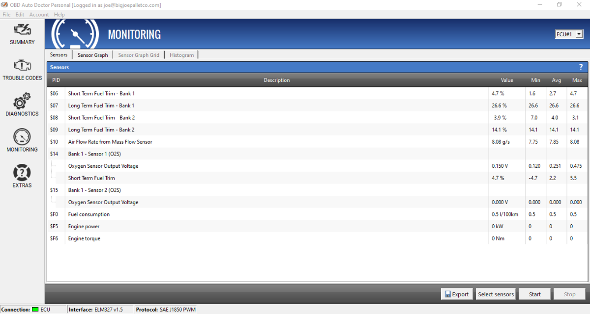

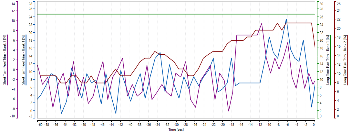

I've got an O2 sensor that is throwing codes and causing misfires. P0171 and all the misfires are on odd numbered cylinders. Fuel trim just sets at 26.6% on the long term fuel trim. I cleared the data and drove around while watching the OBD data. Goes right to 26.6

B1S1 O2 is generating voltage according to chart
O2 voltage is under 1 volt
0.1v is high oxygen
0.9v is low oxygen
Chart shows B1S1 min. as 0.12 and max. as 0.45, so it is reading oxygen levels, just HIGH Oxygen levels, from the misfires
Sweet spot is 0.4, so upsteam O2s should have swing of 0.2v to 0.6v, and they jump around alot, that's normal
Downstream O2s should be steady as most of the Oxygen is burned up by Cat converters, so 0.75v to 0.85v
O2 sensors also can not work under 650degF, so exhaust must be fully warm up before "they" can be trusted, lol
Usually 4 to 5min of run time
They are Heated O2s so will usually work within 1 min of restart
