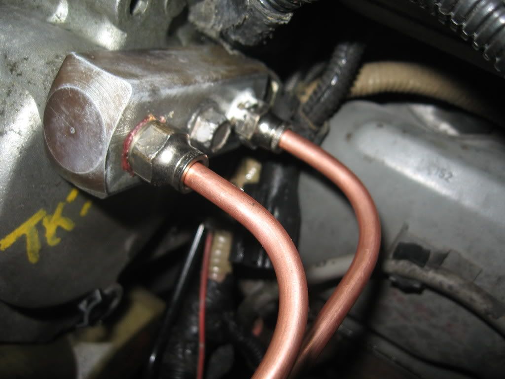

I welded up the stock holes after cutting off the pipes and just tapped the backside of the manifold using 1/4" NPT Pnufit "push to connect" fittings on all the components.

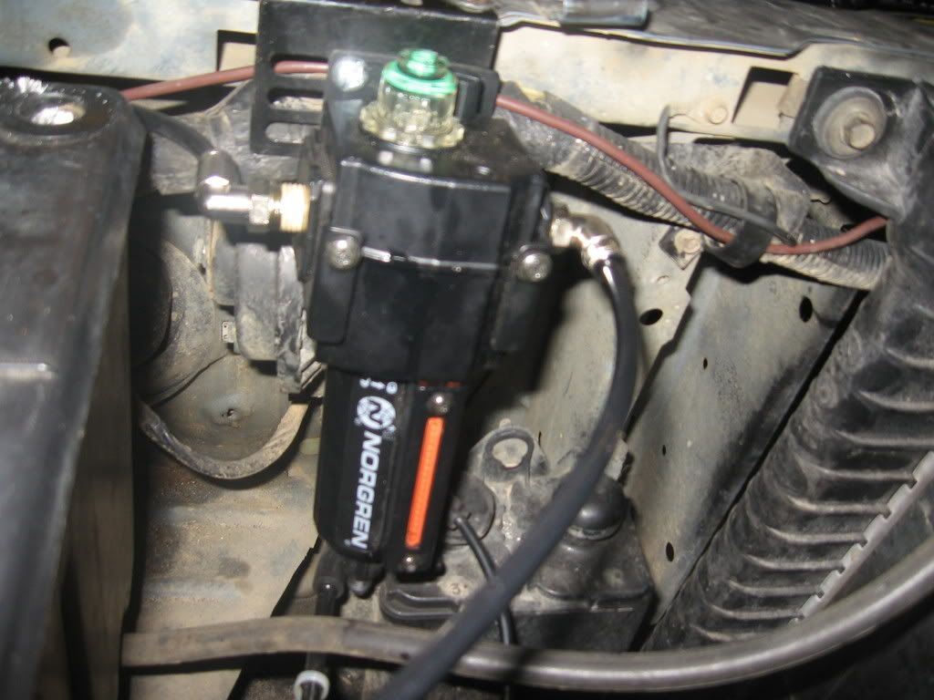

Lubricator.

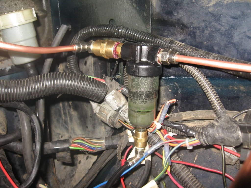

Oil separator with spring loaded check valve.
