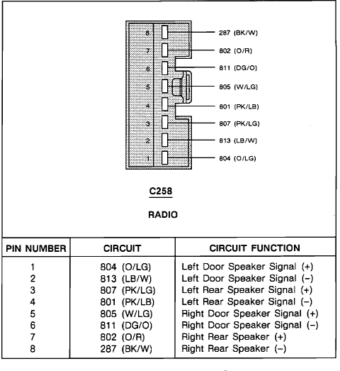

My Stock '93 unit powers on, has antenna reception, and the tape cassette seems to work, but I'm not hearing anything out of any of the four speakers. I don't have the Premium Sound version, and I searched online for potential problems and I found that the radio will not put out sound if one of the speakers is grounded out. My plan is to take out the unit, put a small battery voltage through the harness pins for each speaker and determine if they make noise or not.
Is my approach correct or do you guys suggest something else?
Here's the pin out of the connector harness if that adds anything to the pot.

Yes, that will work
More than likely the amp is bad, but yes most amplifiers have a "protect circuit" so if speaker wire drops below 3 OHMs amp will shut down.
You can just use an OHM meter on each speakers wires, should read 6-9 OHMs, then OHM each wire to cab ground to see of its 0 OHMs, shorted

Sweet thanks for the suggestions. I will try that out tonight. You mean the internal amp to the radio unit? Since this isn't the "premium sound" version there isn't an external amp behind the glove box. If internal, is it a part that I can replace?
Yes, the internal amp.
Probably not but never looked inside one?
But you would need a working radio of the same model to get another amp out of and if you had that................well just install the working radio
Fair. Alright I'll see what results the troubleshooting produces. Thanks for the tips.
So I measured the resistances of each speaker and they were all about 6 ohms. I then measured between each pin and ground and none came up as 0 ohms. Hmmm... then I guess it's internal to the unit. I'll have to open it up and see.
