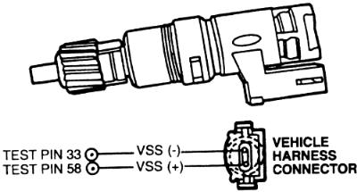

From 1995-1997, check the VSS (Vehicle Speed Sensor) on the transmission/transfercase. Could be bad.
1) Turn off vehicle and disconnect the VSS cable.
2) Using a Digital Volt-Ohmmeter (DVOM), measure the resistance (DVOM ohmmeter function) between the sensor terminals on the VSS (not the cable).
3) If the resistance is 190-250 ohms, the sensor is okay.
